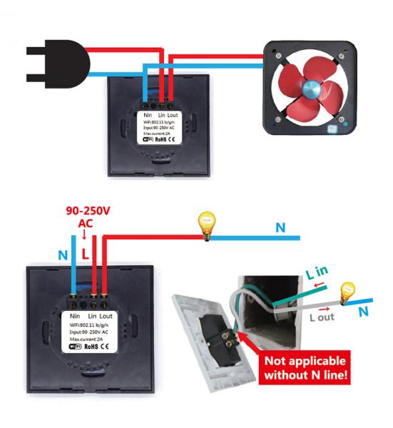

      @GCE , see attached images of the back of the actual device maybe thank you for the assistance thus far ....Click image for larger version

        The existing switch wiring is Blue/Brown going to back of the current Clipsal S2000 one way switch and then i have a stray earth (green/yellow) not connected to anything sitting all by itself in the wallbox. If you need a pick i will see if i can supply one this evening
          • 1473
          Brown is a strange color to use , in this part of the world anyway, - I am assuming that you have a live going in and a switch wire back out - You are missing a neutral wire for the Sonoff switch .
          You would need a contractor to pull in a neutral wire from the light point to the switch assuming that you have conduit coming down to the switch box
