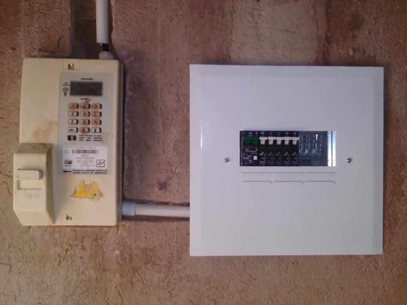

                This is the DB in question.
                  • 1483
                  Hi
                  That would fail a COC inspection without labels ( SANS 10142-1 : 4.2 pg 61 ) and no blanks , ( readily accessible live terminals 5.2 pg 63)
                    Originally posted by GCE
                    Hi
                    Depends on who is checking...i was recently called in to do inspection on a hospital installation (as an independent inspector)...none of the DBs had labels...i was advised that the labels where busy being printed and that i should still issue the COC's...i refused and my payment was rejected because i didnt issue the COC's for the 30 DB which didnt have labels...i am not even going to go into the state of the wiring and having to help the "electricians" figue out the 2 way switching.
                    the other inspector who was passing the DB's which i failed... didnt feel labeling was a valid reason to fail them.
                      I can't see from the picture, is there a main OCPD?
                        Obsessive-compulsive personality disorder (OCPD) ...i doubt it
                        An over current protective device is not required...the circuit breaker feeding this DB will be suitably rated to protect the cable feeding this DB...well it should be.
                        The earth leakage device is being used as a main switch which is normal...just a pain in the butt for the tenant...having to fiddle in the dark trying to find the DB to reset it...unless they are smart like some of us and have a solar system installed with backup power and lighting.
                          Hi
                          Alright! Thanks.
                          I'll ask if he is aware of the labels or not. Maybe he'll bring them along when he come to issue COC.
                          • Ishmaelmo
                            • Apr 2018
                            • 43
                            Hi
                            I'm lost. What is a OCPD used for?
                              OCPD = over current protective device ie circuit breaker that trips at a predetermined current or could even be a fuse. Some earth leakage breakers don't offer over-current protection, only earth leakage protection.
