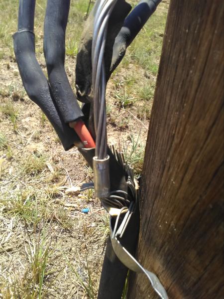

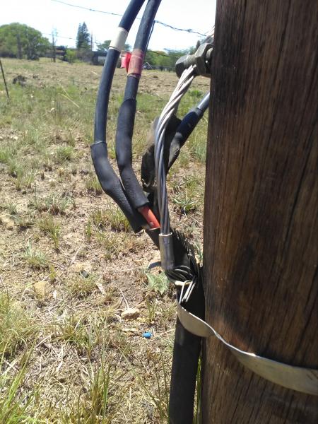

I have seen the municipality guys just link the neutral and earth at the pole.
Next question - is it TNC-S (because its linked at the pole) or is it TN-S (because that's what it looks like when I look at the mains position)
Have you seen what happens when a Neutral goes missing in a TNC-S system - it ain't pretty.
