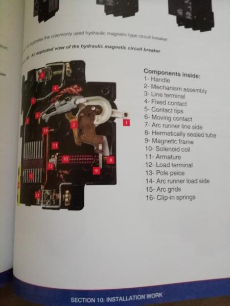

I have attached a picture of the inside of a circuit breaker and you will see label 12 which is the bottom is the output/load.
I know that most breakers don't have live and load on them but they do have a diagram on them and normally numbers, 1 on to then 2 underneath on the diagram and so on.
