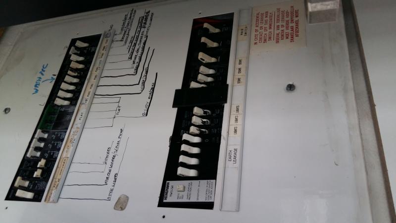

    4. He says the DB needs new labels. The labels are legible, but some are different to others as more have been added over time. My father used black permanent marker to label more precisely what each CB is for so instead of a label that just says plug.... he marked each one with exactly what its for in black marker. I cant imagine that a preprinted label is going to be more descriptive than what is written in permanent marker.

      4. He says the DB needs new labels. The labels are legible, but some are different to others as more have been added over time. My father used black permanent marker to label more precisely what each CB is for so instead of a label that just says plug.... he marked each one with exactly what its for in black marker. I cant imagine that a preprinted label is going to be more descriptive than what is written in permanent marker. the regulations are specific about it being a permanent fixed label. a marker wont be acceptable.
