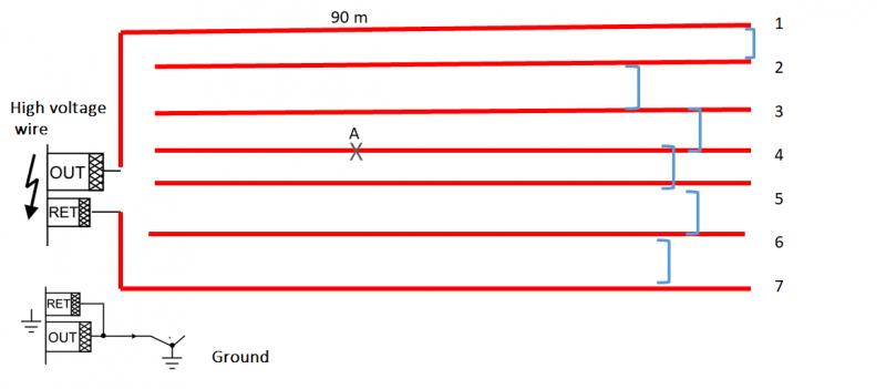

    Dear,
    A technician installed my 7 lines (90m per line) Druid LCD 13 like this (see the google link bellow): shorting wire at the end of the lines.
    I need you advice about the 2 following points:
    1) For example if the wire 4 is cut at the point marked with X , does the Druid detect this cable cut?
    2) If the shorting line is not done like on the schema, the check light goes on. What can lead to this situation ?
    Your precious advice are welcome.*

    Installing an electric fence must legally be done by an accredited electric fence installer who knows what he is doing.
    It is clear from this picture that the installer was neither
    To answer your question, no, the alarm will not sound if the wire is cut at the point marked X
    Additionally, there are no earth wires in the electric fence which reduces its effectiveness
    Before employing anyone be sure to ask for their accreditation certificate be it an electric fence installer or an electrician.

      Thank you very much for your reply and advice . I suspected something was wrong. will work on it to enhance the system:the earth wire, loop, etc.
