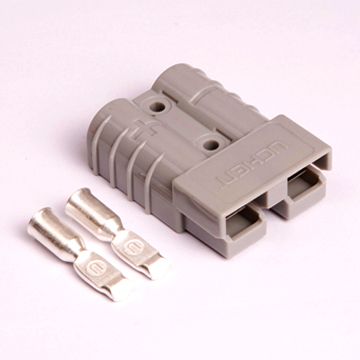

The question... anyone have a cool system using plugs to connect the batteries?
This is something i am looking to do for my home automation project... i want to be able to plug and play... be able to remove a pack anywhere in the stack without having to shut down and fiddle with each battery.
What i would like to achieve...
A steel case/trunk with lots of ventilation for the batteries ...not sure yet which ones i am going to use... price is a huge factor.
A double pole DC circuit breaker mounted in the enclosure... which can isolate that enclosure batteries from the rest even if it is plugged in.
A female DC plug with a lead from the enclosure.
A roll of male plugs (this could get interesting) if you plug in the other racks these will be live...so maybe a daisy chain system on the enclosures... or a row of double pole isolators.
