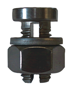

          Greetings All
          I have to rectify a generator installation as the previous contractors install the generator before councils meter.
          I have to extend the 150mm cable which is armour cable (solid stranded copper) and I want to crimp onto this cable 150mm single core flexible cable ( braided copper cable), does anyone forsee any challenges with this?
          When you say braided copper' I'm assuming it's fine stranded wires...
          Just crimping with a ferrule is fine if the cable is glanded into an enclosure and joint is inside. Line tap connectors or DIN mount stud terminals would be another couple of options that have the advantage of being servicable in future. If the cable is trailing and you're jointing the cable with ferrules you should use a resin joint to give strain relief.
          DIN Mount Stud Terminals
          Line Tap Connector
