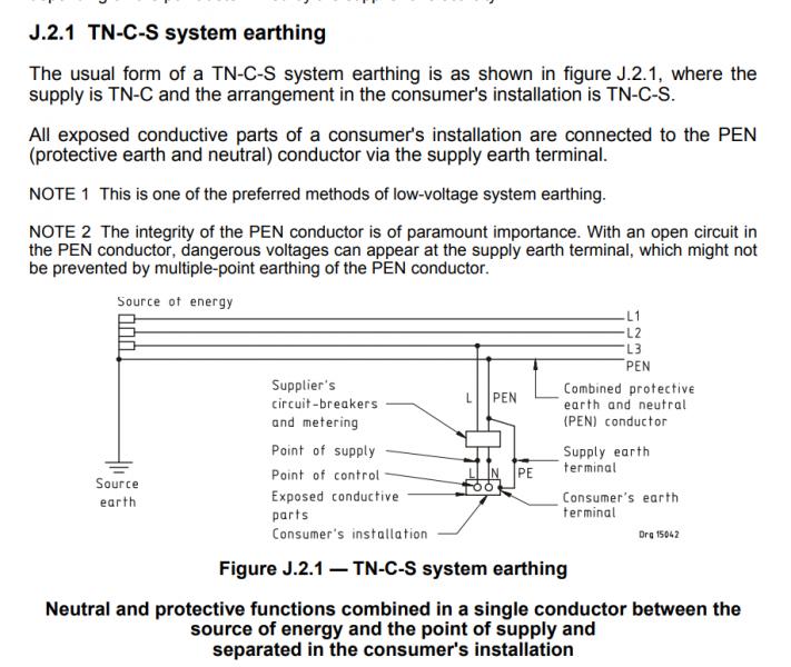

            No spike required - that's just a TNC-S systemClick image for larger version

              Jaws, you are 100% correct, it is not necessary.
              That said, having an earth spike at the installation will reduce the chances of dangerous voltages appearing on the bodies of earthed appliances should there be a break in the PEN conductor between the supply authority and the installation.
              Peace out .. Derek.
                Just a note ... its not as simple as knocking a spike in the ground ... you need to do a ground restistance test ... back in the day when i built water treatment plants around the country ... we had to use earth spikes ... boy did we have some fun trying to get the ground right for a spike ... sometimes a mat is required.
                With having a spike/mat in the ground you start introducing other issues ... potential difference between the supply neutral and the earth spike ( unless you link the neutral and earth spike at the meter box)
