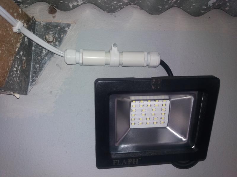

              Thanks for the tip, Ian. Tried your idea today. Simple, yet brilliant. Will use it for downlights as well in future.
              Peace out .. DerekClick image for larger version
                Peace out .. Derek[ATTACH=CONFIG]7971[/ATTACH]
                How is this legal?

                  Actually a very good idea DOES THE TWO PLUGS TURN OUT FROM EACH OTHER?
                  the lights cable is very short everybody is complain about it.
                    Have a closer look at what it is

                      Originally posted by Leecatt
                      How is this legal?
                      Hello brother. What, if I may ask, makes it illegal ? The connections inside are crimped with ferrules with heatshrink as insulation.
                      Peace out ... Derek
                        Peace out ... Derek
                        6.3.7.2 b is a good place to start. There are others.....
                        Sent from my SM-A705FN using Tapatalk
                          I think its a brilliant idea ... or you can pay R85 for one of those silly joints which does pretty much the same thing.
                            Maybe what i should do is 3 D print a piece of plastic which can fit a pushin gland on either side and put a 20 mm round hole in the middle ... then its not in a connector, bend, elbow or Tee-piece of a conduit.
                            R 1.50 per pushin gland plus a piece of plastic R5.00 ... way cheaper than those silly little cable jointers sold for R50-R80 ... talk about a rip off.
