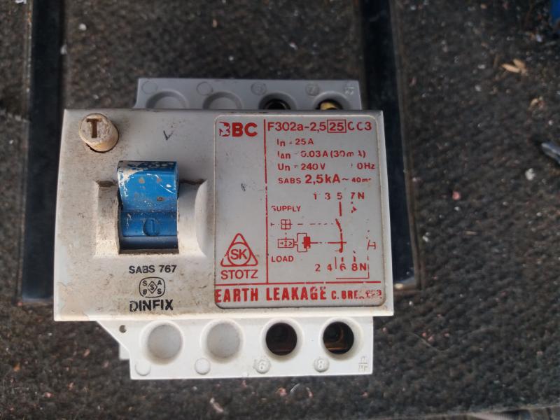

                      Hi Mark
                      Interesting. I have also come across a number of them in one area here in Slummies. An area called Buffalo Flats. All of them are din rail and all of them had BBC switchgear like the earth leakage in the attached photo.
                      There must have been a special on at a certain time for these populated db's.
                      Peace out ... Derek
