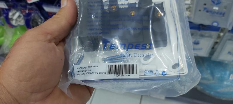

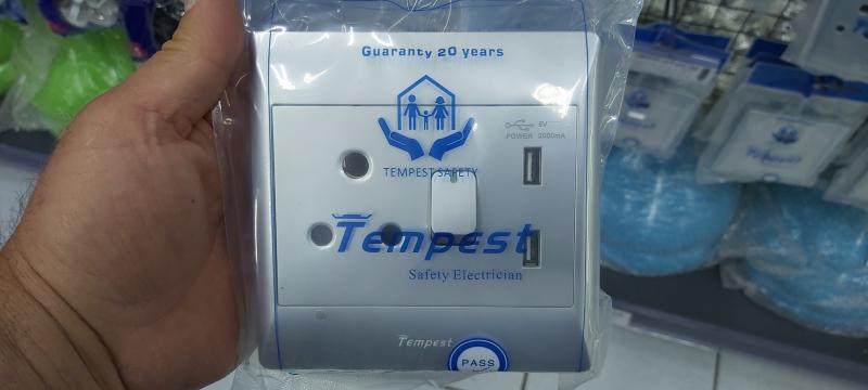

          I saw these on display in a Chinese shop at K90 Center, Boksburg. Note the SABS mark as well as the 20 year guarantee.Click image for larger version

            Originally posted by Leecatt
            I saw these on display in a Chinese shop at K90 Center, Boksburg. Note the SABS mark as well as the 20 year guarantee.[ATTACH=CONFIG]8337[/ATTACH][ATTACH=CONFIG]8338[/ATTACH]
            Chinglish - Guaranty?
            The art of copying
