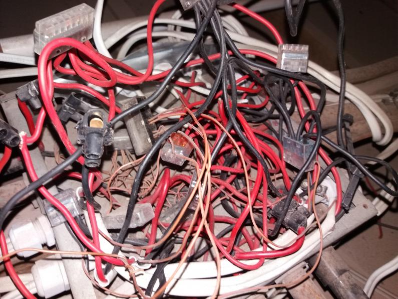

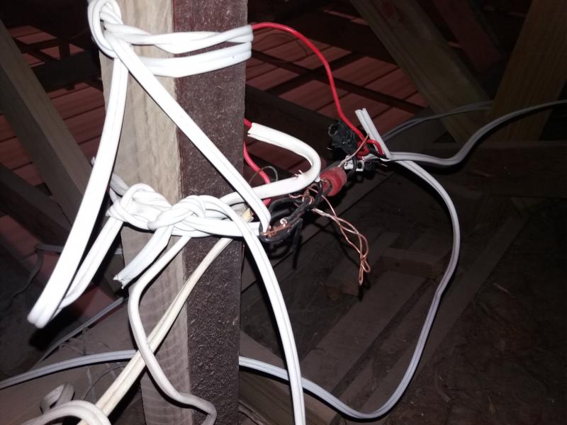

    Xolani and I have some work to do tomorrow. .....
    Lusikisiki sparkies have been on site again.
    Peace out.

    WTF
    What others issues are lurking elsewhere?
      A typical electrical installation in SA ... nowadays its difficult to separate electrical installations from alarm circuit and CCTV ... they all just as crappy.

        It would cool (and educational to some I am sure) to see an "after" photo(s) once you have fixed this.

            Something to note ... really crappy untidy workmanship doesnt make the installation non compliant.
            These pics do display non compliant components.
            it would be interesting to see a list with relevant non compliance ... as per the code.
              • 4927
              That wiring in the enclosure is very strange... the original steel conduits were correctly made off then they've glanded the flat twin cable entries and they've used wide range of relatively expensive Ideal type connectors then if just went pear shaped when they started using 0.5mm stranded wiring by the looks of it and left the finished result looking like a rats nest.... Those cables literally lashed around the wooden post I've got absolutely no idea what went on there.
