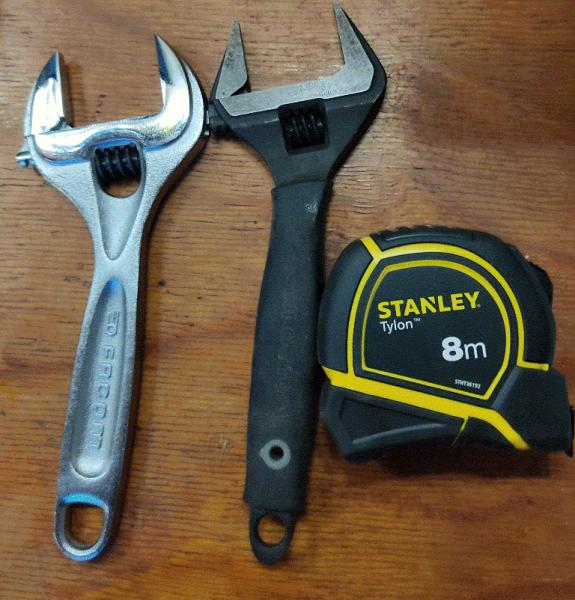

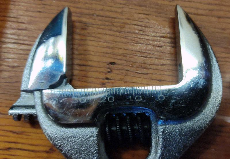

    The top picture shows both the Facom spanner and the Monument spanner side by side, the tape measure is just there for scale.

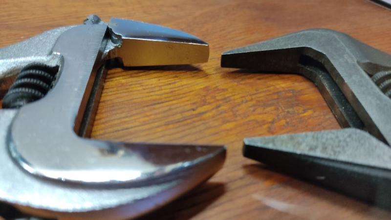

    Starting with the Facom spanner, it's very short (about half the length of a normal shifting spanner) which means it doesn't take much space in the tool bag and it's relatively light compared to normal shifting spanners. It's very well built and engineered which means it doesn't twist or slip even under high force and it has a corrosion resistant finish. The jaws are thinner than a normal shifting spanner which means it can get onto nuts which are very close together. Finally and most importantly it can get onto a nut that's 45mm across the flats which is enormous.

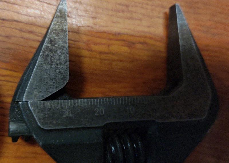

    The Monument spanner has similar attributes, it's also well engineered with very little play and float in the jaws. It's also very short and it can accomodate a very large nut that's 39mm across the flats. It has thinner jaws than the Facom version and it's jaws are also tapered thinner towards the tips which means it will sometimes access an awkward nut that the Facom spanner can't.
    I'd say both spanners are superb and neither is better than the other. It's a shame the Facom jaws aren't a little thinner and it's a shame the Monument spanner isn't chromed because it does get light corrosion after time. Both spanners score an individual 9 out of 10 which is high praise indeed. As a pair they compliment each other perfectly and as a pair I'd score them 9.5 out of 10.

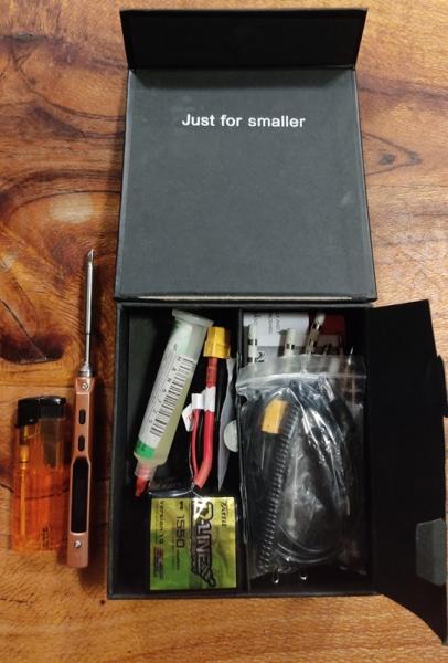

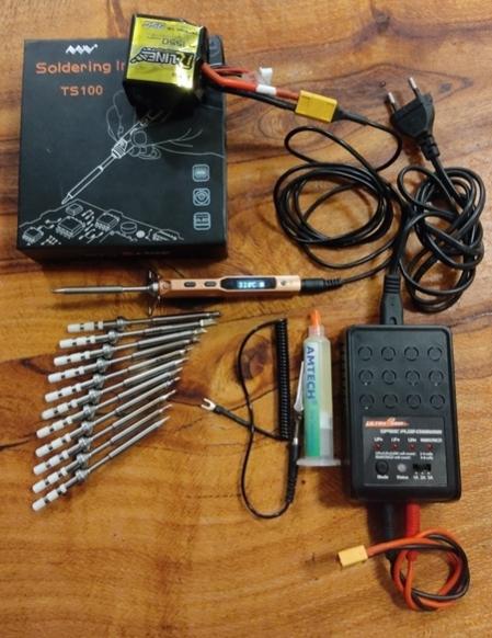

                After several decades of disappointment everything changed when I came across this little beauty;
                It's a battery operated portable soldering iron that will run on any DC supply between 12 and 24 volts. This alone is a game changer, it means you can run it on your bench supply if you do board repairs or you can use a small lithium ion battery like I have in the picture. It will also run direct from a car battery or the car cigarette lighter socket if you're doing automotive work and you can even get or make an adaptor to run it from an 18 volt powertool battery in which case you won't need to carry a special battery for it.

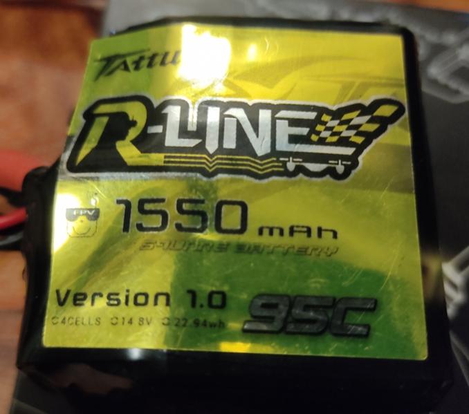

                The heat-up speed and temperature recovery speed of the iron varies depending on the voltage of the supply. At 12 volts it will take around 20 seconds to heat up fully from cold which is pretty quick but at 24 volts the time reduces to about 7 seconds which is rediculously fast. The little battery I use is a 14.8 volt Li-ion that is often used in remote control cars and the warm up time is more than fast enough for me. If you're going to be using it a lot on items that sink a lot of heat or larger size wiring like 4mm or 6mm I'd suggest an 18-24 volt supply would be better.
                Part of the reason it's so fast is that the heater is right in the end of the tip rather than traditional irons where the heater is in the main body of the tip and it takes longer for heat to transmit to the end where it's needed. The temperature is fully adjustable and the temperature sensor is also in the end of the tip which means it reacts very quickly to temperature changes and keeps a very accurate and constant temperature when it's in use. This also means it can punch way above its weight for its wattage. I have to admit I was skeptical when I bought it but I've been pleasantly surprised at what it can do, with my battery at 14.8 volts it's a 20 watt iron and I've soldered 6mm lugs onto wires at that power. If you use an 18v battery it will be a 40 watt iron and at 24 volts it will be 65 watts but I've never needed more power so I've never used it with higher voltage supply.

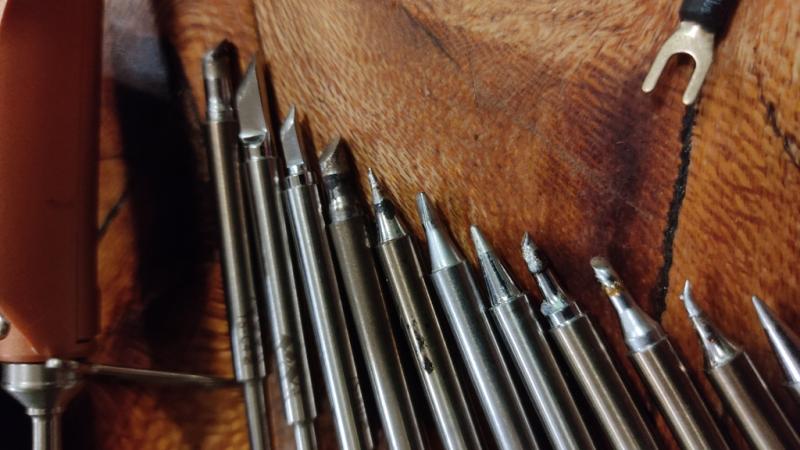

                The range of tips available is pretty impressive with various sizes of conical, chisel, beveled and pointed tips available. I carry the iron in the box it came supplied with along with the battery, some flux, a tip cleaner, various sizes of resin cored solder and the 3 tips I most commonly use. It's portable, light and I don't carry the charger because it operates for at least an hour on a single charge. It also has an idle function when you don't use it for a minute or two and its built in gyroscope sensor automatically reheats it to set temperature as soon as you pick it up again. It's also ESD compliant and it comes with an ESD cable you can connect to your mat to avoid static damage to components being soldered.
                The iron is programmable and there's several versions of firmware available that change specific features. You can also write your own firmware if you're that way inclined.
                Overall I can't fault this soldering iron, it's been my goto iron for both bench repairs and for field work for about 2 years. The build quality is great it's soldering power is admirable, its portability is great and its functionality is flawless. This iron would be a great choice for for tradesmen and also for someone doing board repairs and electronics on a bench.
                As for price, I'm going from memory here so this is only a guide, I paid about R1100 over 2 years ago and it came with a couple of tips and the ESD strap. On top of that you need a battery and I think I paid about R400 for my little battery and the charger. I bought a wide selection of tips from Wish . com and I think they were about R250 each but it just so happens the tips also fit my Hakko bench soldering iron so they're dual use for me. Then there's sundries such as R100 for Amtec flux and probably another 100 bucks for a tip cleaner and some decent solder so it starts mounting up. All in all I'd guess you could do it on a budget of R1.5k for the iron and the sundries if you were using a powertool battery you already have in your tools but in my opinion it's well worth the money.
