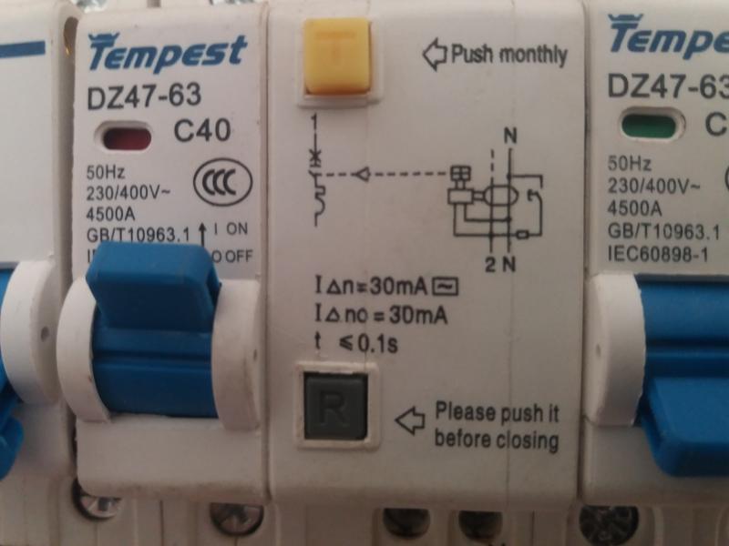

                    • 1765
                    Hi All
                    From the photo, would you say that this earth leakage offers both overload and earth leakage protection ?
                    Cannot find anything online.
                    Derek
                    • Dylboy
                      • Jun 2020
                      • 777
                      Originally posted by Derlyn
                      Hi All
                      Derek
                      [ATTACH=CONFIG]8334[/ATTACH]
                      I would say yes due to the symbol. The little Astrix thing. Pg 341 of SANS Ed. 3. Will attach screen shot of table, the symbol for a circuit breaker
                        • 3517
                        #26
                        According to this web site it is a 40A circuit breaker as well.
                        The symbol is an electromagnetic device used for the tripping mechanism, not sure the origin though.
