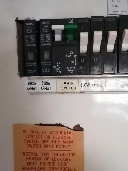

    Our insurance broker recommended getting a surge arrester for the DB the electrician fitted 2 one for live and one for neutral.
      We still have to specify items for "surge damage" even if we have a "lightning protection" device in the DB ... they said it is not the same thing .. best you verify and get it in writing ... with the page and clause that covers you.

        [ATTACH=CONFIG]8403[/ATTACH]
        Looks like the left hand surge protector might alread have failed or maybe the green indicator light is just very dim....
                The left hand protector never flashes just the right hand one flashes I thought it was just that it was on the neutral and the other on live. That's what I was told when it was fitted.

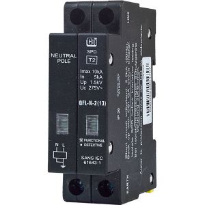

                  Apologies, I didn't look too closely at the modules you have. Usually a 1-pole and neutral surge arrestor would be fitted like this one

                  You actually have two separate 1-pole modules which aren't designed to go on the neutral hence the indicator lamp doesn't work.
                    So you never know when it has failed then?
                      No, you won't know if it's failed and needs replacing.
                        They shouldnt flash the green light on means it is functional ... when the lights goes off it needs to be replaced.
                        As pointed out by Andy whoever installed 2 line units ... clearly doesnt seem have a clue what they are doing ... I wonder if they fitted the busbar at the bottom and the earth wire and used the correct size wires ?
                          While we picking your poor DB to pieces ... best you get a dremel and engrave the current rating on the circuit breakers ... then take tipex ... paint it over the engraving ... then rub if off leaving the current rating visible ... other wise every is going to tell you to replace the breakers due to the crap poor quality labelling on CBI breakers.
