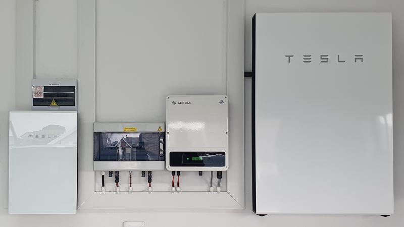

      I find the regulation clear with regards to separation
      We tend to run a U shape trunking when it comes to inverters and DC cabling and use a split trunking if need be .
      We have also run cable tray with a P8000 in the tray for Data cables to keep separate
      Have attached reg below that I feel is relevant and a pic of the latest install.
      6.1.7 If conductors that operate at different voltages run in the same wireway,
      the insulation of each conductor shall be able to withstand the highest
      conductor voltage in the wireway. Alternatively, the conductors shall be
      separated by a continuous barrier of insulating material or earthed metal.
      6.1.10 Conductors that form part of a d.c. installation shall not be run in the
      same wireway as conductors that form part of an a.c. installation.
      3.85
      wireway
      open or enclosed route or support such as a rack, tray, ladder, ducting,
      trunking, sleeving or conduit that is intended to contain conductors or cables
      NOTE A wireway can consist of one or more separate wireway channels, each of
      which is intended for different services such as installation wiring and
      telecommunication wiring.
