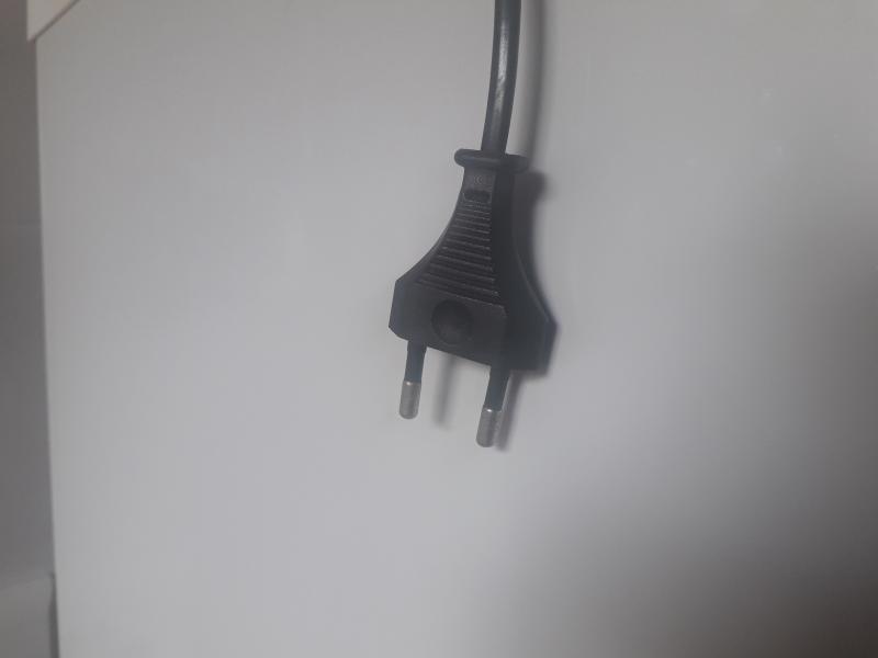

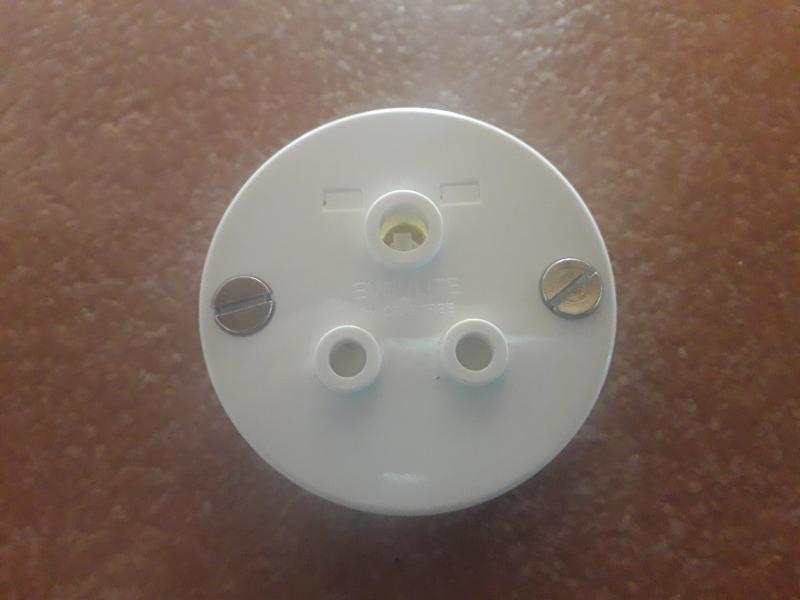

                      It would be cool if Crabtree could manufacture these
                      To accept these
                      • Isetech
                        • Mar 2022
                        • 2274
                        [ATTACH=CONFIG]8513[/ATTACH]
                        To accept these
                        [ATTACH=CONFIG]8514[/ATTACH]
                        They do accept them, you just need to push a screwdriver into the earth terminal.
                          • 1748
                          Even if you do that, they dont make decent contact.
