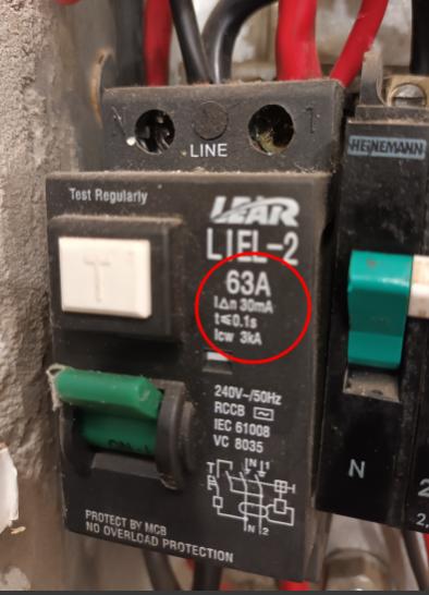

        Why is the earth leakage not tripping ?
        By using simple ohms law you will see that any insulation resistance above 8k ( 8000 ohms ) will not cause the ELR to trip.
        R = V/I ................ R = 240/0.03 = 8000 ohms. ( 8k )

          Thank you Derlyn! Been tossing and turning all night.
          Oh course! Makes perfect sense. Resistance HAS to be low (or under 8000 ohms) to trip.
          High resistance won't trip as the milliamperes fall below the sensitivity of the ELCB.
          Low resistance = dead short or a very good connection between conductors or between conductors and earth - depends what you're testing.
          Ok my mojo is recharged and I am ready to go back and test as you suggested!Click image for larger version
