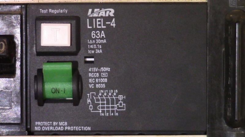

    Hello all. Recently we had our very old Heinemann ELCB replaced with an RCCB without overload protection. The lack of overload protection made me wonder if we really have all the needed electrical safety devices.
    I'm not an electrician and I'm working from the assumption that everything I thought I knew about electricity is wrong. I am a total noob when it comes to electricity. I have a few questions I'm hoping you'll be able to answer.

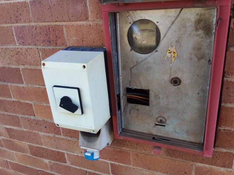

    Here is our own meter box on the outside of the house. There used to be a switch/breaker in that opening below the round window, but was replaced by the switchover device on the left we had installed to connect the generator.

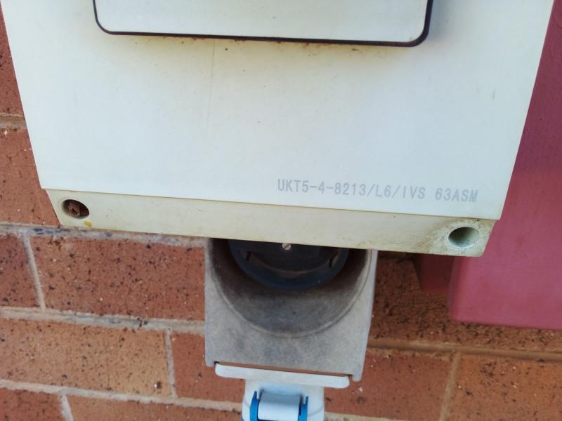

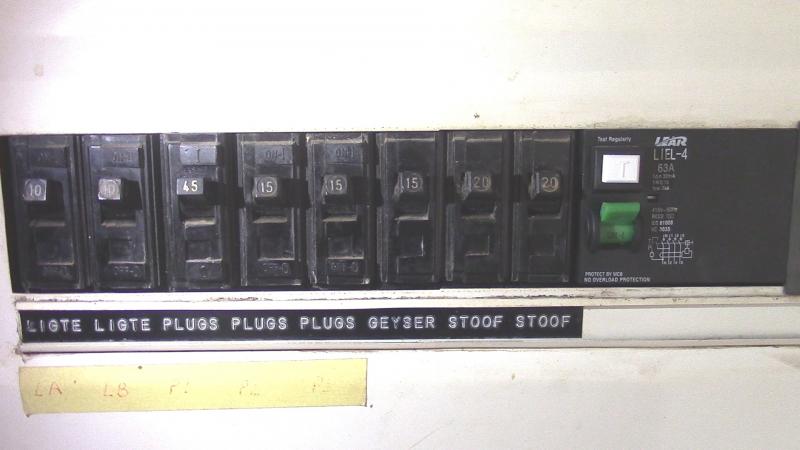

    Here is the distribution board and the newly installed RCCB.

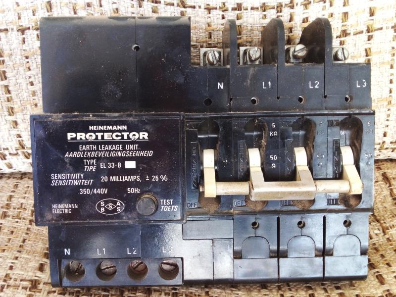

    Here is the old ELCB we had replaced. Pressing the test-button didn't trip the switch. Electrician confirmed the device is faulty. I couldn't find out if it had built-in overload protection.

    1) I understand the new RCCB won't protect against short-circuits (live wire touching neutral) or any other situation where too much power flows through (unless the difference between the live and neutral is 30 milliAmps or greater), correct?
    2) The switches labeled "plugs", "ligte", etc are the miniature circuit breakers (MCB's) and they're supposed to trip if too much power flows through the circuit, correct?
    3) What are those numbers printed on what I assume are the MCB's?
    4) Should I have a circuit breaker (that trips if too much power flows through) re-installed in the meter-box on the outside of the house?

    As indicated on the new earth leakage unit there needs to be a circuit breaker added and it must be on the load side of the earth leakage. (6.8.1)
    If the is no space available for an extra circuit breaker then a new earth leakage with integrated protection must be used

          Like Leecatt said you need a RCD with overload protection or a seperate main switch at point of supply disconnecting phases and neutral.Are you using a 3 phase generator? Is the changeover switch a 4 pole if you are using a 3 ph generator. Reason for different readings on kwh meters loads between phases are not balanced.
            That is correct - the RCCB that is installed is an isolator type and will only trip on leakage to earth.
            Correct
            If you are referring to the 10 on the Circuit breaker for lights - That is the max amount of current that cab flow , being 10Amps
            There should be a C/Breaker in your meter box to protect the change over switch and wiring - It needs to be rated correctly

              • 22820
              Originally posted by stuffies
              7) Can you see anything missing/wrong safety-wise?
              There is a 45 amp circuit breaker marked as a PLUGS circuit which merits closer investigation.

                There is enough evidence in the photos to open a full investigation.

                  Thank you everyone! My dayjob and loadshedding kept me from replying sooner.
                  All of you basically confirmed my suspicions that all is not right. In particular, there is a lack of overload protection. I don't really trust the MCB's tripping-ability any more, since they are as old as the previous ELCB (at least 40 years old), which was old enough to not work correctly anymore. So the MCB's may or may not work.
                  So as a minimum (as I suspected) it appears the MCB's need replacement and a circuit breaker needs to be installed in the meterbox (our own, not the municipal box). A proper investigation will probably reveal more.
                    Sent from my SM-A528B using Tapatalk
                    Thankyou. The "6.8.1" seems to refer to a regulation? Where can I read more on this?
                    • Leecatt
                      • Jul 2008
                      • 406
                      6.8.1 Circuit-breakers used as main or local switch-disconnectors
                      A circuit-breaker that is used as a main or local switch-disconnector (see 6.9.4) shall comply with the relevant requirements of a standard given in clause 4 for switch-disconnectors, or, alternatively, a switch-disconnector shall be positioned on the supply side of the circuit-breaker.
                      • BobZA
                        • Oct 2018
                        • 20
                        Why does he need to add a circuit breaker ? He replaced the old RCCB with a new RCCB ... and the RCCB acts as the local switch disconnector
                        • Leecatt
                          • Jul 2008
                          • 406
                          I'm not familiar with the term RCCB. If an RCCB is an earth leakage disconnector with an integrated circuit breaker, then that will suffice.
                          If it is an earth leakage disconnector with no integrated circuit breaker, then a circuit breaker must be installed on the load side of the earth leakage disconnector.
                            Yes he needs to add a 63a mcb before the RCD as this unit does not have overload protection if he had installed a RCD with oveload protection then it can be used as a main switch at the moment there is no overoad current protecting the 16mm incoming cable except for the council kiosk.

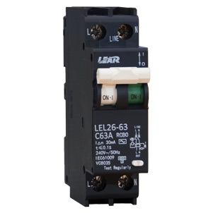

                            • Alfred M
                              • Feb 2022
                              • 130
                              If you want to use Lear as jou have then the unit you need is the one in the picture. I am not very fond of the Lear units they are difficult to reset.
