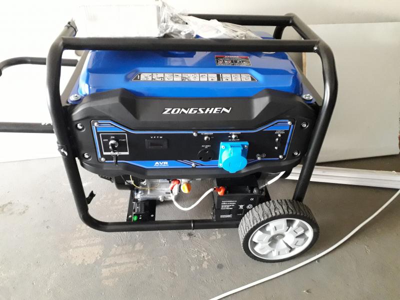

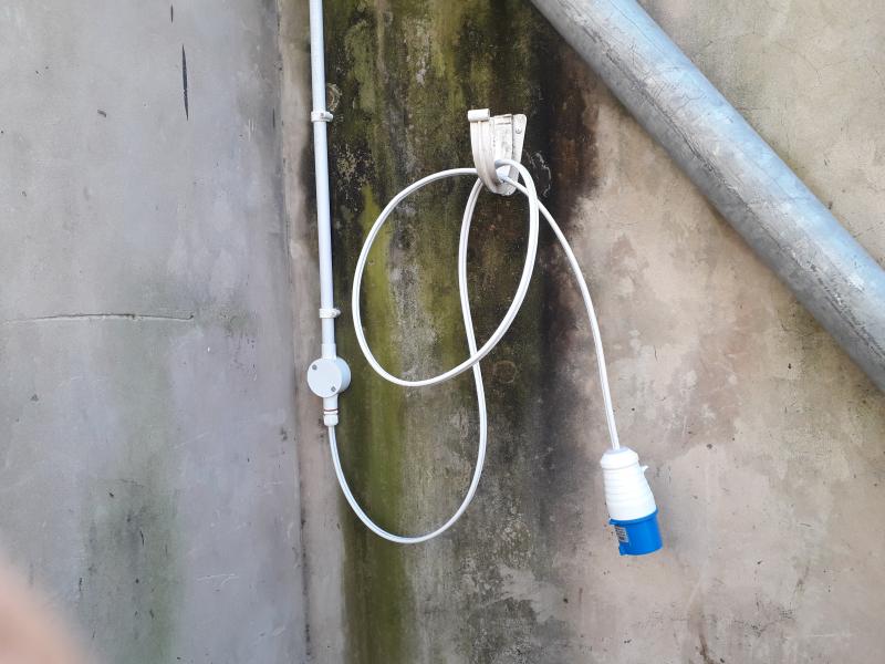

    Did a generator installation yesterday.
    The generator that the client purchased already has an industrial socket fitted.
    First time I've seen this on a new generator. Photo attached.
    So it wasn't necessary to fit a socket on the wall and make up the lead with 2 plugtops.
