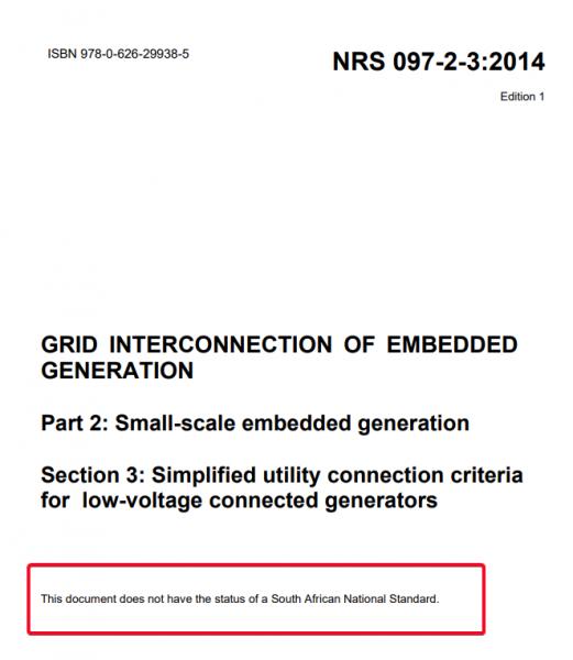

            Under which Regulation is this document enacted by law?
            https://www.sseg.org.za/wp-content/u...l-2014_B_W.pdfClick image for larger version
              • 1483
              https://www.sseg.org.za/wp-content/u...l-2014_B_W.pdf[ATTACH=CONFIG]8557[/ATTACH]
              According to their website , Electrical Regulations Act ( Act No 4 of 2006)
              The National Energy Regulator of South Africa (NERSA) is a regulatory authority established as a juristic person in terms of Section 3 of the National Energy Regulator Act, 2004 (Act No. 40 of 2004)

                      Hi Pieter,
                      I see no mention of " ALL PV INSTALLATIONS MUST BE REGISTERED AT SOME COUNCIL" in this Act.
                      It seems to be aimed at GRID INTERCONNECTION OF EMBEDDED
                      GENERATION only.
                      YES i would give a coc to a customer if the installation complies
