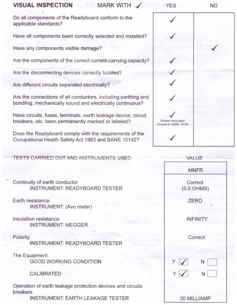

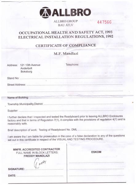

    When buying a ready box, there's a COC as attached, inside.
    What is that COC used for and is it worth the paper it's printed on ?

    How can it say screws have been torqued to Sans 10142... Surely the manufacturer would specify the setting ?
    And even have a value for Earth Resistance it should be N/A ?
    Also how can the earth leakage tester be 30mA... I am yet to see a ELU trip at 30mA also do they then put power Into the board to test ?
    And what is a readyboard tester ??
    I don't think that paper is worth anything

      As we all know, you just need a certified document, this would be a certified document
