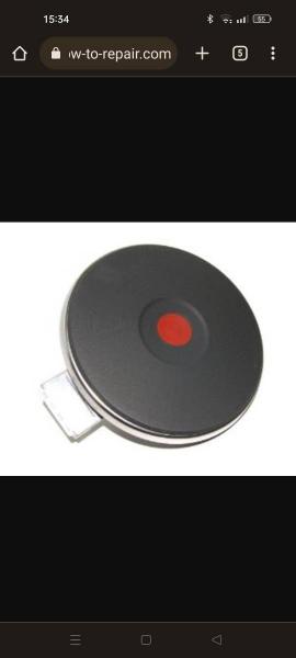

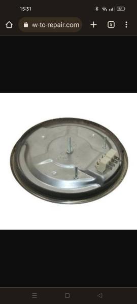

    Hello
    I don't do appliances but this is one I want to try sort.
    How do I remove this type of stove top. I didn't take a pic of the one for some silly reason.
    But it's a Bosch 4 plate stove.
    The plate is a solid one, do I just info the middle but and push with force out ??
    Attache is a pic of what the solid plate looks like. Top and bottom
    Any guidance would he very appreciativeClick image for larger version

    Never done it myself, but it looks quite simple as per this video, https://www.youtube.com/watch?v=o3Nt...hannel=eSpares

        A 10mm spanner is your friend. Loosen the nut in the middle of the plate underneath. That nut keeps the securing bracket in place. Remove the nut completely and the plate comes out very easy. No force needed.
        Good luck loosening the screws that secure the wires. They usually corrode vas and the wires need to be cut off and bootlace ferrules crimped on. Other than that ... easy peasy.

          masking tape to label the 4 wires, you mix them up you need to understand the element and switch configuration, rather just label them and even better take a picture if you not sure. I normally just put the tape across the 4 wires to keep them in place.

            Yeah I undid the bolt, was partially undine already but the whole stove had the Stove jam thank uncle above said so I think it was like glued on... So I stopped as force is not always the answer and decided I will ask and do some research and see if the one at home is the same to try (have an old one removed from Aunts house)
            I don't really want to get in this side, it is interesting but as stated the bucks on it is tough if not carrying the right spares. But I want to get into it a bit to help the good clients.
            Yes ya this plate only has 2 wires going to the plate, ones I have seen before have 4 as stated. If I get the job will take a pic for you all

              The easiest way to check how many wires it has, turn the switch, if it clicks on each number, then it should have 4 wires, the switch bridges the 2 element in series and parallel to change change the heat.
              If it moves freely as you turn the dial, it has 2 wires (simmistat switch), 2 of the terminals will have bridge pieces, linking the 2 elements.

                  A spiral stove plat only has 1 element, so it will only work on a simmerstat switch.
