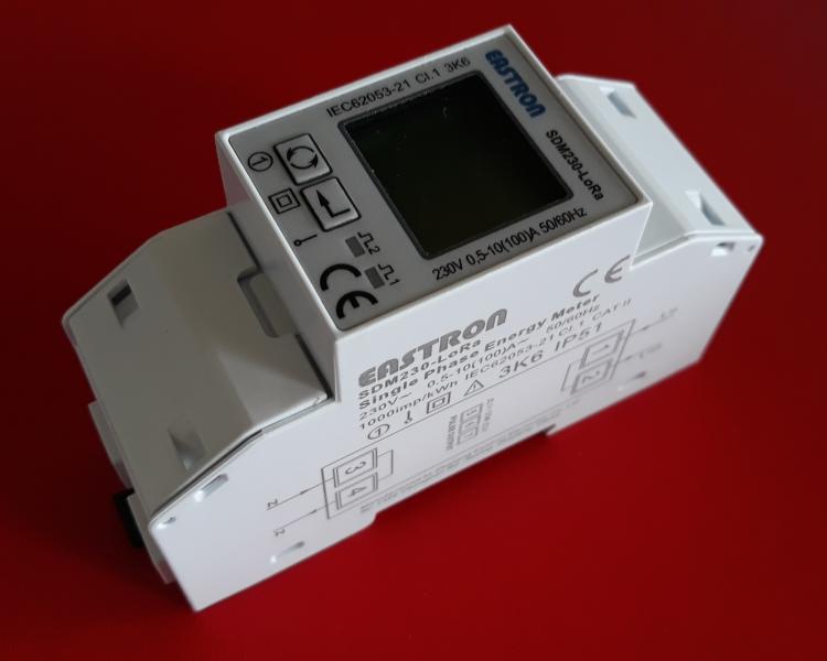

Check out the AUS-iot Monitor. A LoRa enabled electricity meter communicates with the LoRa network. No need for a gateway where there is existing cover.
The tenant gets an Android app to monitor his own meter and the manager/admin gets a dashboard to monitor all the meters.
Meters can be read from anywhere in the world. Data is stored in the cloud.
The meters are read on the hour and readings for the week/month can be downloaded in a CSV file or is also compatible to most accounting packages for billing purposes.
Cost effective and reliable. Subscription is R31 pm incl or discounted at R333.50 p.a.

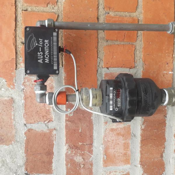

No, the AUS-ioT Monitor is not prepaid, but an AMR device for reading meters remotely from your armchair or office.
Connected to a water meter, it turns your meter into a smart meter and reading on your phone.
It gives you the reading on the hour as well as alerts for pipe bursts and leaks.
