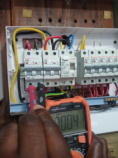

                        #146
                        Originally posted by GCE
                        I would hazard a guess and say you are going to be back there for a mains incoming neutral fault - Could be that there is a loose connection coming into the property and that every now and then it utilizes the inverter neutral due to the bonding
                        @ GCE. You are a foretune teller supreme.
                        Was called back on Friday for no mains power.
                        Main breaker faulty. ( Replaced )
                        After carefull inspection I noticed the telltale brownish burn mark on the neutral side of breaker.
                        I can only assume that the breaker was on it's way out and that there was a high impedance across the neutral contact inside.
