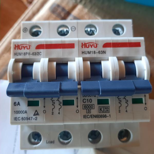

    A client want me to connect her hybrid fridge and freezer for her.
    It comes standard with panels, a ac/dc panel at the back of the fridge and a 4 pole ac/dc breaker with a holder for wall mounting.
    I don't see a link to attach an image of the breaker, battling with connection at the moment.
    No cabling included but there is three solar panels, the breaker and holder and a manual included with the fridge and freezer.
    The breaker work as an isolator in an emergency, so I guess it must be within arm's reach of the fridge.
    My question is: Can I use cabtyre feed from the plug to the breaker or do I have to bring a wire in from the db, under earth leakage, to the breaker?
    From the breaker holder can the cabling be open or is neater and safer to run it in two pvc tubes?
    HAs anybody out there done and installation before?
    The fridge is a Defy Hybrid fridge, D200 model for those who is wondering

      Based on some research it looks like the 4 pole is a dc breaker, for panels and battery. The fridge got a built in pwm regulator or something similar. The motor is 12vdc inverter motor and can save you up to 44% in electricity, they claim.
Name:	acdc breaker2.jpg
      Will borrow the manual on Monday to make sure what I need in terms of hardware and how to install it. Hopefully next time it would be easier
