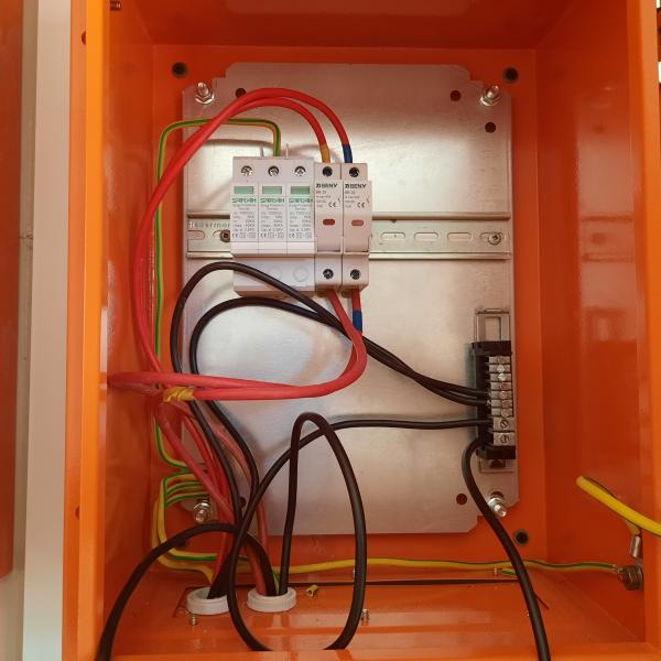

    There is two strings coming in and only one string is connected to the spd in the combiner box.
    There is no dc isolator or dc breaker in the combiner box only 2 fuses for the red strings, the black strings go to a neutral bar and can't be isolated.
    Orange enclosures, with no inner door, had been used for the PV combiner box and the AC combiner box.

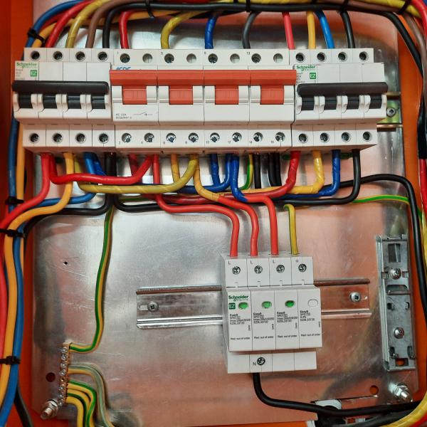

    The AC combiner box have two 4 pole mains, I insisted on them, for Eskom incoming and Inverter Incoming and a 3phase change over.
    It would have been nice to have a third 4 pole mains so that one can split Eskom incoming and the Inverter Outgoing but since nothing other than the Inverter is using Eskom it doesn't really matter.
    Oops on the picture the bridges to the spd is not in but they had been done, just not on the picture
    Any feedback would be welcome

    The incoming strings need to be able to isolate both pos and neg - pos and neg wires do not have voltage labels
    Surge arrestor is not connected and looks like a 3 phase surge arrestor , not DC but not sure as cant see ratings
    The bypass switch should be bypassing inverter in and inverter out - You are achieving nothing by bypassing Eskom to inverter in
    Looking at the 2 pics you have sent it appears to be fraught with errors and would guess that the balance of the installation is a disaster
