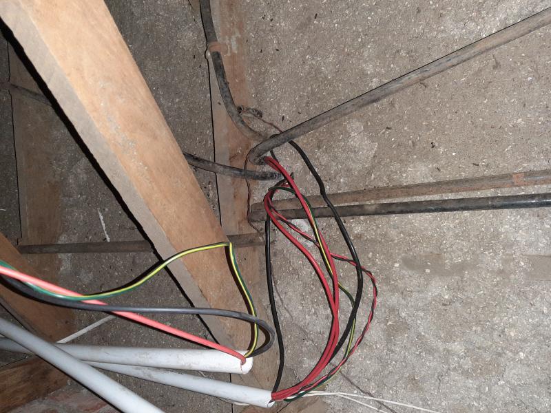

    When getting into the roof space a completely different story. open exposed wiring, some from solar panels and some from DB going through
    roof space to a separate db for inverter.
    My question is, is this the norm, or how would a top solar inverter company do his roof workClick image for larger version
    There is no such thing as a Solar Inverter company - There are Registered Electrical contractors that specialize in Solar installs - If they are not registered , then they are illegal operators out to scam people
    So his roof work should be like any other electrical contractor and works out of the same set of regulations

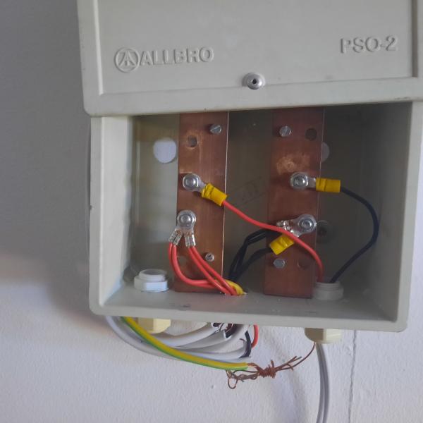

            The db, live on one side and neutral on the other with earth tied in at the bottom

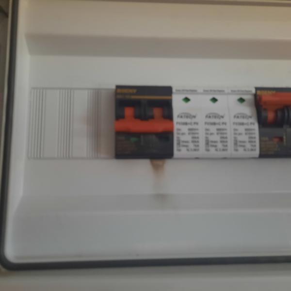

            60Amp isolator burned due to lightning

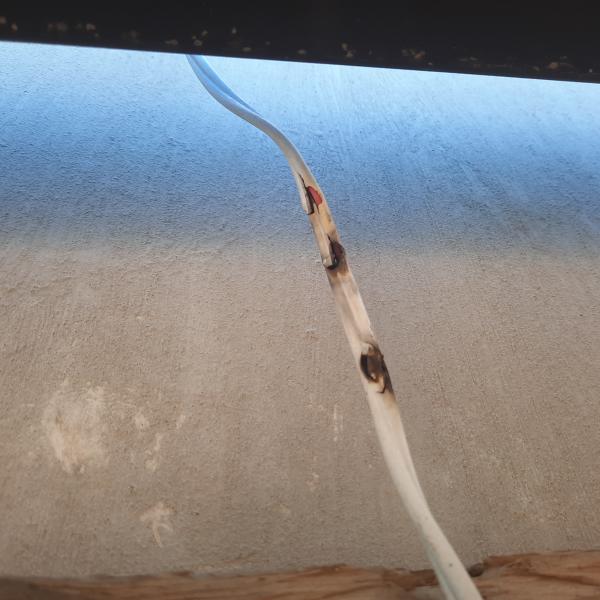

            Twin and earth, on the outside of the building, burned in three places where it jump to the carport frame
