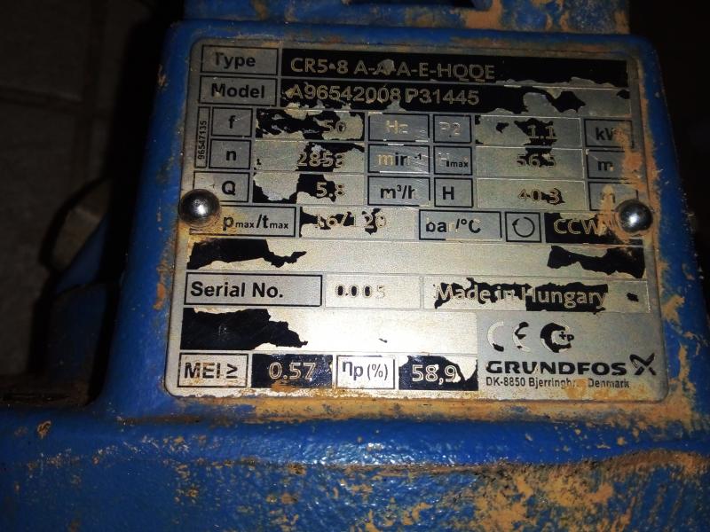

    [Question] 3phase pump nameplate
    Can someone please explain to me on a 3phase grundfos waterpump nameplate what does mei and np% stands for?
    • 1473
    MEI - Minimum efficiency Index - It has to do with the efficiency of the impeller to deliver water at certain heights
    np% - the n has a long side to the n and stands for efficiency - It would indicate the motor power efficiency in % and is often rated at different loads
    The above is my understanding from an electrical side and I am no expert in the mechanical side of pumps
    • Josh van Niekerk
      • Dec 2022
      • 4
      Thanks GCE for responding so rapidly.I have searched for 2days for this info on this motor and you made it very easy for me.
