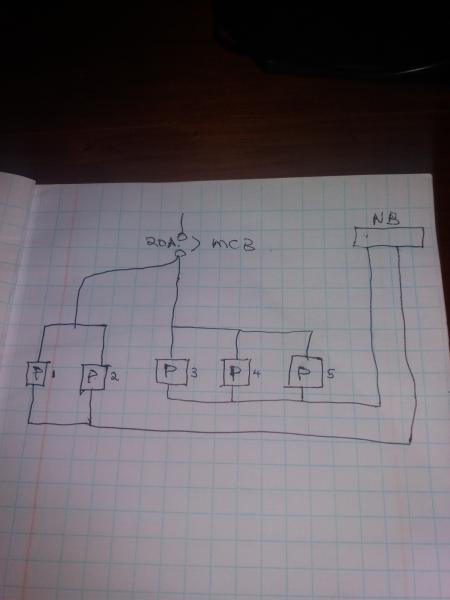

    Definition of a circuit.
    In the following photo .......
    Socket outlets 1 and 2 are in the garage.
    Socket outlets 3, 4 and 5 are in the lounge.
    My question is ....... are there 1 or 2 socket outlet circuits ?

    1 circuit breaker, would indicate one circuit.
    However, unless the garage is linked to the house and there is open access, ther emight be other challenges to consider.
      • 1748
      This has always puzzled me and I might be guilty of issuing hundreds of coc's that are in my opinion fauly.
      On the attached circuit diagram, I have always considered it to be 2 circuits. 2 lives leaving the db and 2 neutrals returning to the db. In my opinion, the fact that they are fed from 1 circuit breaker is neither here nor there.
      On my test reports, the number of plug circuits is quite often not the number of circuit breakers in the db.
      I'm trying to establish whether I have been right or wrong.

        When I do an electrical installation I use white heat shrink to mark each circuit (live and neutral) no matter how many wires in the circut breaker (not more than 3 and not larger than 2,5 and all the other rules that apply) all those wires in the circuit breaker are labeled as 1 circuit. What I might do is label 1 a , 1 b , 1 c to make it easier for me to identify if I have to fault find. In most of my installtions there is only one wire per breaker and I certainly wouldnt connect a lounge and garage plug circuit on one breaker, especially if the garage is not attached t the house. Many houses especially in complexes are attached to the house, you would have to be careful if you find one of the through boxes back to back, because of the fire rating.
          • 1748
          Ok. So what you are saying is that a circuit breaker can only supply 1 circuit irrespective of the number of lives it supplies and neutrals returning. Interesting.
          That means I've been wrong all these years.
          Wonder what the other toppies say ?

            I read it as 2 circuits
            When in doubt - read the definitions from SANS 10142-1
            When you read the definition 3.11 and 3.14 , in my opinion it is pretty clear that the reference to circuits is the conductor/wire and not the circuit breaker
            3.11
            circuit
            arrangement of conductors (see 3.14) for the purpose of carrying electric
            current
            3.14
            conductor
            material that is capable of conducting electric current

              Interesting, this statement would make every single COC I have issued since 1986 incorrect.
              I dont agree, but hey thats just my opnion.
              The way I see it, if you switch off plug circuit 1 fed from circuit breaker 1, all the plugs connected to that breaker/circuit will be switched off.
              Do you identify the circuit breaker as plugs, circuit 1 and 2 ?
              If you have 3 wires connected to a plug in the middle of a room and they branch out from there, do they become circuit 3/4/5 ?

                • 1748
                Thanks GCE.
                That's been my understanding.
                I was taken to task for indicating 6 plug circuits when there were 4 plug breakers so I had to open the DB to show them that 2 circuit breakers each had 2 circuits connected to them, giving one a total of 6.
                I also pointed out that the test report indicates the number of circuits and not the number of breakers.
                I feel better now knowing that I have been correct all along.

                    • 1473
                    If they wanted you to count circuit breakers they would have put down circuit breakers - Instead of putting " count the wires under the circuit breaker " they put down circuits which is defined as a conductor
