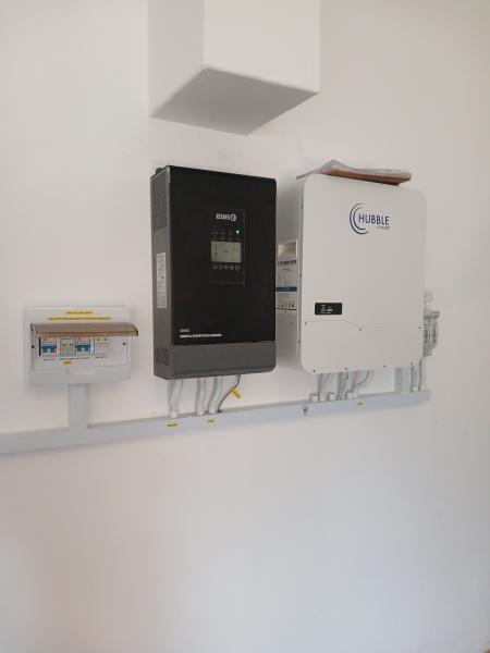

      What does one do when the inverter does not have a selection for lithium batteries ?
      Did an installation for a bud the other day. Ellies inverter ( I think same or similar to Mecer ) no lithium battery selection available.
        • 1473
        [ATTACH=CONFIG]8860[/ATTACH]
        You will have to set up voltage settings - problem is that you have no warranty on the battery as the BMS does not control
        It is not an ideal situation and you need to be careful of fitting lithium batteries to inverters as not all inverters will talk to all different batteries
        Before suppling and fitting check manufactures specs as to which batteries are approved for there inverters
