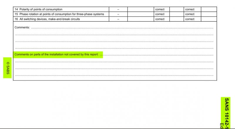

                    Contrary to some narratives created by some articles and statements, YOU MOST CERTAINLY CAN EXCLUDE PARTS OF THE INSTALLATION ON THE COC, AND THERE IS A DEDICATED SPACE PROVIDED FOR THAT PURPOSE ON THE COC UNDER SECTION 3. It would not "render the coc invalid" or be "against the law"
                    Here is an example from sans 10142 of the format of the coc approved by the chief inspector and enacted by law: As you can see there is a clear section to comment on parts you want to EXCLUDE.

                      • 1495
                      [ATTACH=CONFIG]8881[/ATTACH]
                      Maybe I need to clarify
                      If the house is being sold you are doing a COC to state that the entire installation is safe as per fundamentals - You cannot then start excluding parts of the installation , it will come back to bite.
                      If you do an alterations you can cover just that alteration and exclude the balance of the installation that you have not worked on
                      On the sale of a property you would be contracted to check the entire installation

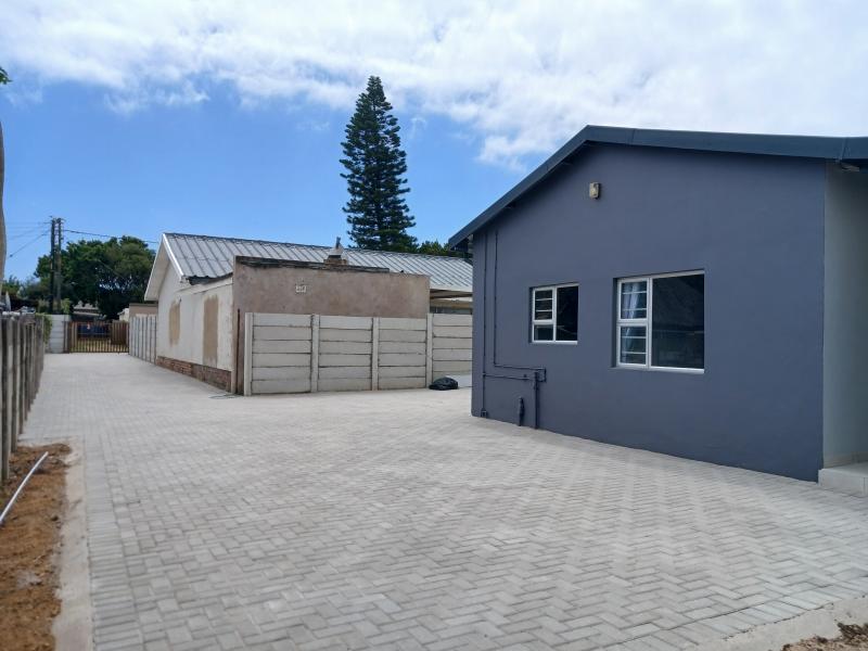

                              We were talking about excluding certain sections from a COC.
                              This cropped up today. Requested to issue a coc for a cottage in order for occupation to take place.
                              This property was bought voetstoots so the buyer needs to organise the COC before occupation. It is one ERF consisting of a main house with a cottage fed from the main house.
                              The property is in the process of being subdivided.
                              The main house is basically still a construction site but the cottage has been renovated and is tenant ready, bar for the COC.
                              I have decided to issue a COC for the cottage with the exclusion being the main house.
                              I think this is a perfect example of using the exclusion facility on the test sheet for what it was intended.
