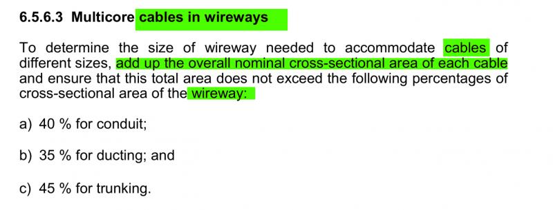

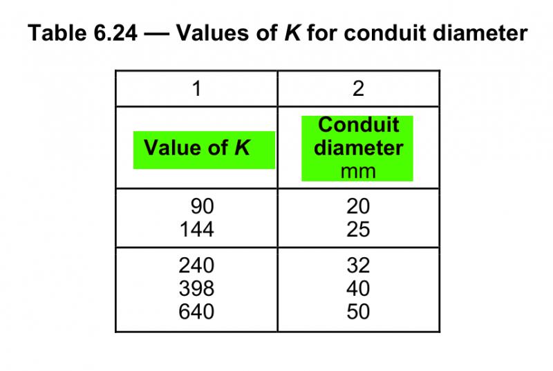

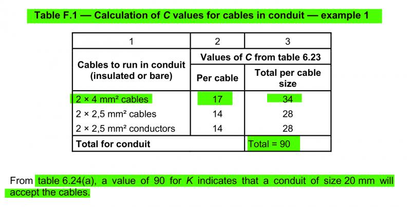

          Hi----This is the only calculation approved by the chief inspector to do what you want to do---The 40% is a requirement for cables in wireways.--- See the following regs and tables regarding conduit sizes and wires inside it. It is relatively simple.
Name:	cable sizes conduit.jpg
ID:	266309Click image for larger version
Name:	conduit size wires.jpg
ID:	266310Click image for larger version
Name:	wireway conduit sizes.jpg

            In the same conduit - Yes - if its big enough
            If you have 2 x 6mm GP (L+N for stove) and 3 x 2.5mm (C.P.C. for stove and L+N for socket) + 1.5mm (for socket C.P.C.) you are at 96 (max 90 on C value on 20mm conduit)
            I have seen where guys use manufaturers data and calculate CSA of all cables in conduit and and they still have 40% space - don't like it but have seen it to justify why they passed it.
