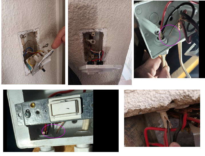

    Reminds me of my very first inspection for my Portfolio of Evidence. I talked a friend of mine into doing an inspection for free and she said she had tripping issues but she found a "very nice electrician who fixed the problem in 15 minutes" and swore by this chaps seemingly psychic abilities...
    What he had done was to cut EVERY earth conductor in the DB and all the socket outlets and geyser.Click image for larger version
Name:	POE Earth.jpg
    Oh how naive I was :-)
    My summary of experiences to my mentor:
    Lessons learned:
    1. Don’t assume or trust anything.
    2. Test your instruments – I had elevated resistance measures on my multimeter (shown in
    the pictures). When I re-tested using the resistance measure on the Megger and compared,
    they were out by over 1,4Ω.
    I discovered that one set of leads was faulty. When replaced the multimeter read exactly the
    same as the Megger.
    3. Take your time. I was anxious by how long inspections take. Be thorough.
    4. Be open with the client – show and explain the faults.
    5. Understand the output of ones instruments.
    6. Always act with integrity
    If the purpose of this Portfolio of Evidence is to show completed CoC’s then I have failed.
    If the purpose is to identify and fix electrical issues resulting in a safe installation, then I believe I
    have passed with distinction.
