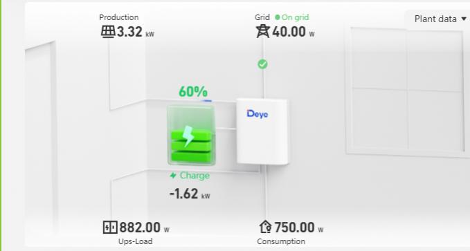

                  On the example below - Sun is capable of producing 3.32Kw - on an offgrid it will only feed battery and UPS load and you would be " wasting " the chances of using the other 750w of electricity - Because this is a true hybrid and can feed back onto his grid it allows the extra solar to feed fridges , oven , microwave etc without running the risk of overloading the inverter
                  the 40w from the grid is to stop the prepaid meter from tripping
Name:	Grid tie example .jpg
                      The 40W is also used for the inverter to identify that the grid is active and for synchronizing
