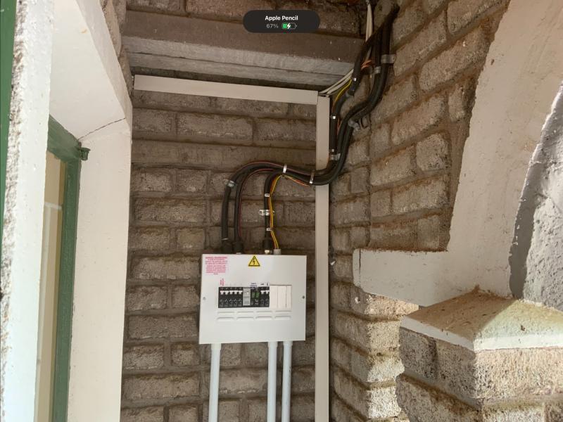

    Dear members,
    An electrical contractor installed a fuse box on an outside wall. It’s under a roof overhang. I asked if this outside fuse box should be in a box, protected from the elements. He said no it’s legal the way it is. Can experts tell me if this is compliant?
ID:	266360 location of box

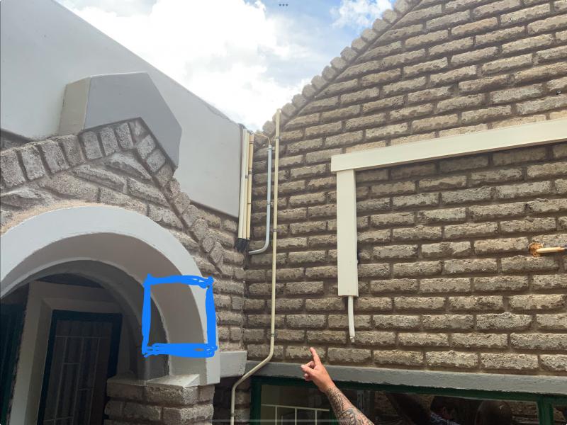

        • Gerhard003
          • Dec 2024
          • 4
Name:	IMG_1077 2 copy.jpg

            now that would help!
            Photos added below

              I don't think one can refer to it as illegal, however, in my opinion, it's not ideal.
              I would have used a weatherproof DB.
              Lets hear the opinions of the other toppies.

                It's a case of "don't like it but couldn't fail it". Yes, I would have used IP rated but it looks like it's not going to be exposed to the elements
                Can't see for sure but looks like that's not a double pole main switch on the far left - that would be a problem for me.

                  It looks like the tray of the DB is a flush tray, is it advisable to use a flush tray on the surface?
                    I'm not sure about those drip loops in the cables being that close to the DB....

                      I still say "A Su1 box with trunking would have looked a lot more professional" but being able to cut an R250 or R300 of your R?? 000 quote to get the job is most important!?
