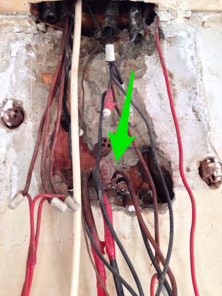

                      This is why it is important to check behind a surface mounted DB, it may look all new and rewired.
                      Spot the code violations.
