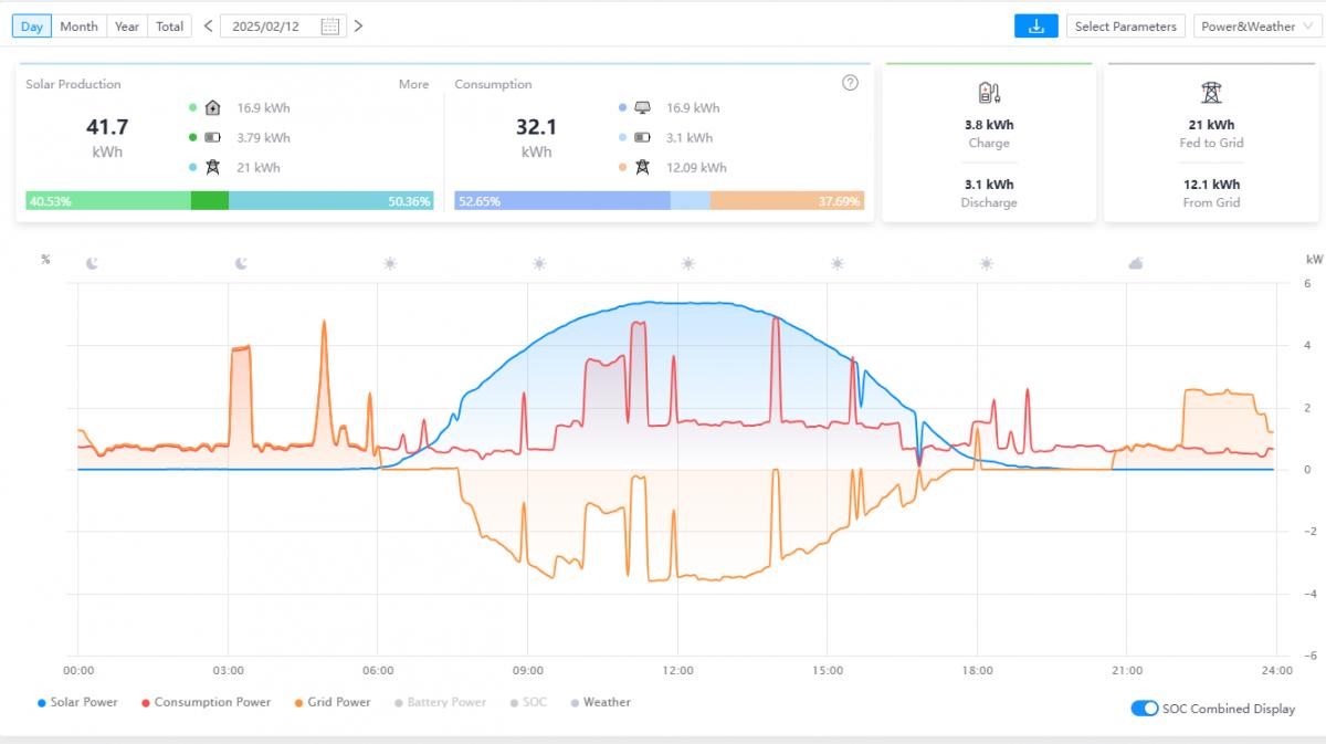

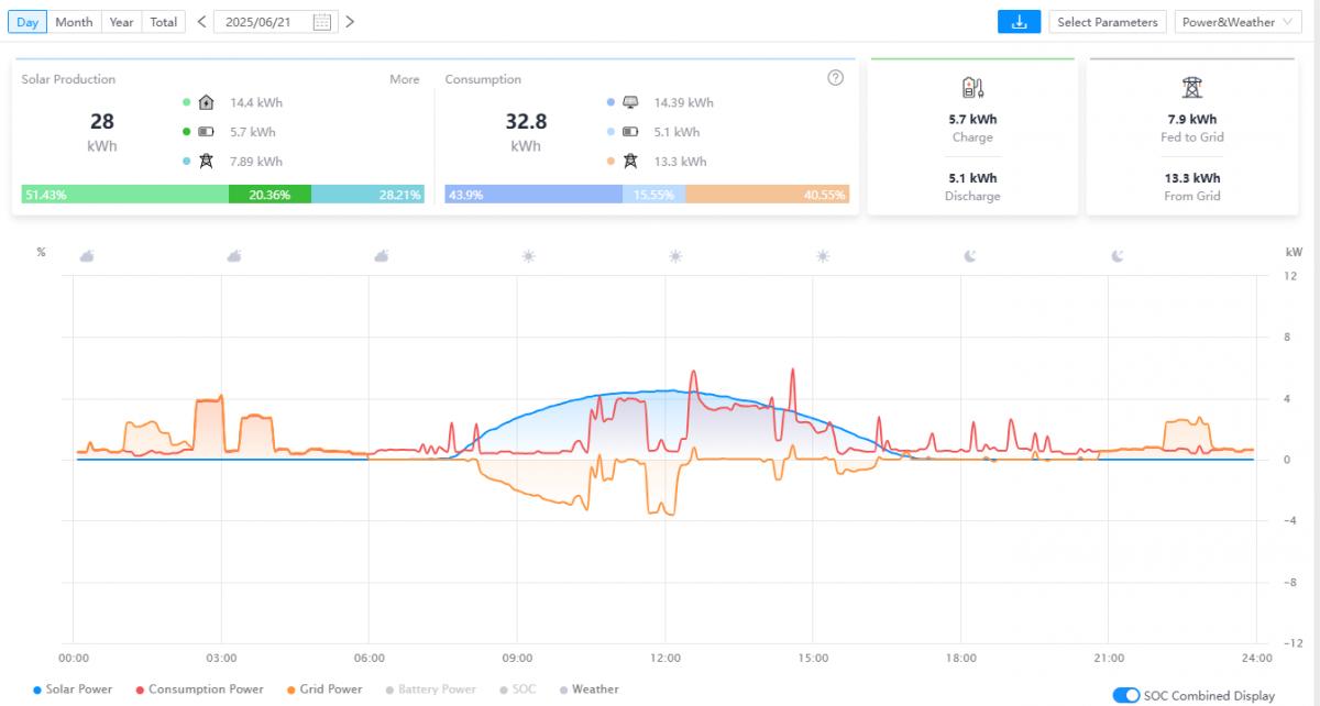

                  • 1495
                  Quickest way to have hot water and reduce electricity bill is to install Solar
                  Start with a 5 or 6kw system - Depending on usage an 8kw is ideal - prices have drop tremendously , install one string for now and the 2nd string as phase 2 , battery as phase 3 and heat the geysers at mid day to 65degrees
                  I sit with 2 geysers , main house and flat - Run them staggered between 10H30 and 15H00 - During summer I don't need to heat again until next day - During winter I top up at night with 2Kwh .
                  When I was on prepaid meter with solar - Was using +/-900 units(according to inverter) and only having to purchase +/-230 units - Average electricity spend went from R3K to R750 .Now on TOU and sitting at R500.00
                  System operational in Sep 2023 Until end Aug 2024 - 12 months - savings R22K
                  from Sep 2024 to end June - 10 Months - R26K
                  With the new increase the savings are now around R 3 500.00 a month
                  Reckon my savings will be around R55K in 2 years - Half way there to system repaid
                  Graph of shortest day and a longish day
