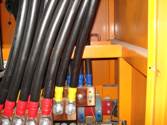

i use it to find hotspots on electrical panels

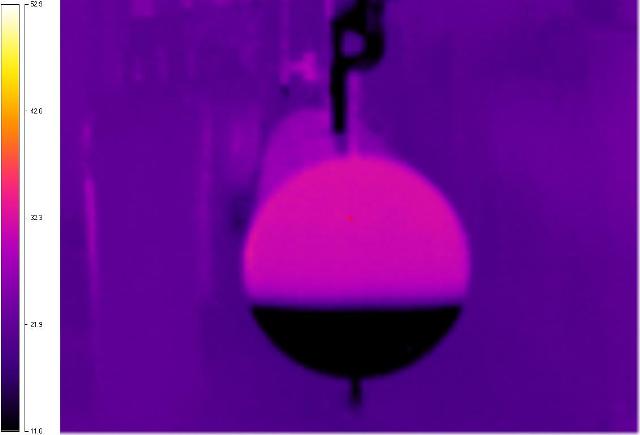

to check liquid levels in tanks

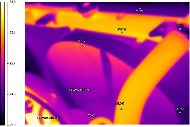

use it to check motor vehicle cooling systems...to verify if the water is working or radiator

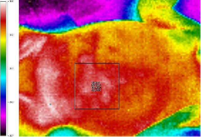

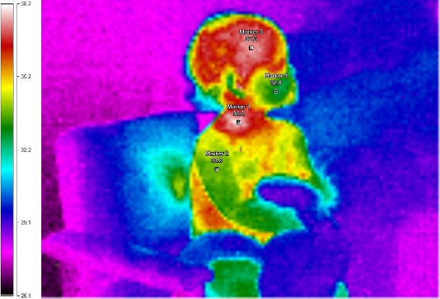

here is an example of my daughter with an ear and throat infection...she cant talk so it is difficult to find out what is wrong...when she gets niggly i just do a full body thermal check and if there are infections arounf her cuts or throat etc
they show then print the thermal image anf take it with to the docComment
this is probably the most important image i have ever taken with the thermal imager...my daughter 3 months old at the time had just come out of hospital from major surgery...a short while later i scanned her and found heating around the wound...so i took her back hospital...the doctors found the cut had got infection...because we caught it so soon they manged to use needles to remove the stuff without having to cut again...and monitored her on a daily basis...she has since recovered nicely.
the image shows heating lower down but that is just from legs...the part of interest is in the block around the cut.Comment

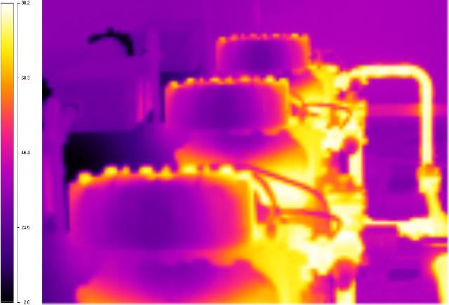

also part of my standard commissioning proceedure...checking the compressors to make sure they have even temp. so we know they are all in good running order...a full radiometric infrared scan is also carried out on all electrical components to check for loose connections and hotspots...i also carry out a full power quality test during commissioning to make sure the incoming electrical supply is correct...there are no harmonics...the motors are running at the correct current...i check for volt drop on start up and inrush current...to verify all the cables are correctly rated...over and above the standard COC tests...it takes a little longer than normal but i walk away from the plant and sleep well at night.
that is why my company logo is
"doing it right first time everytime"Comment

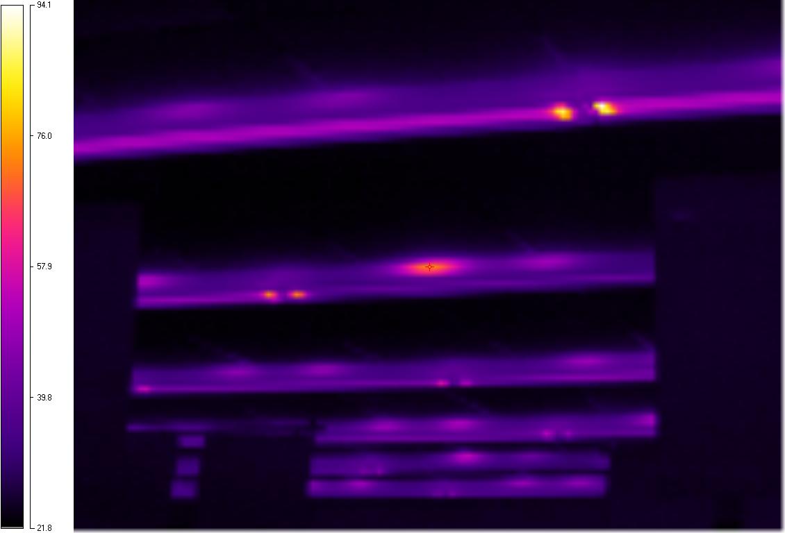

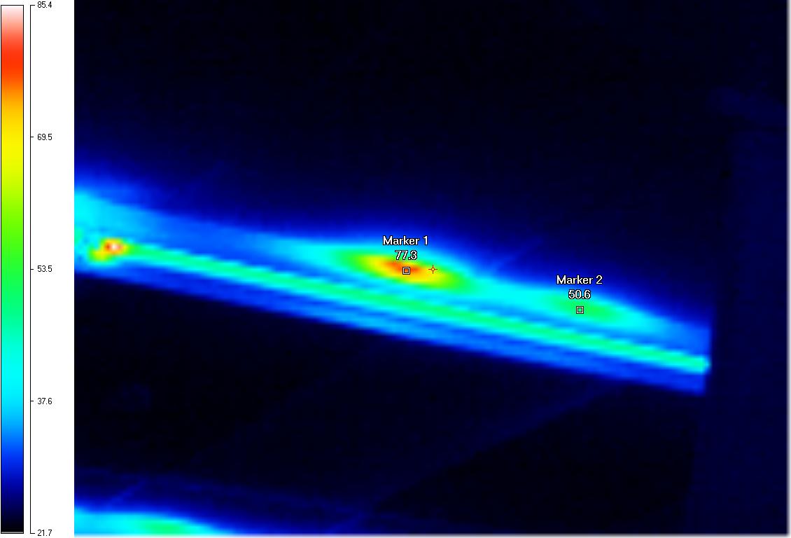

now you ask yourself what the...this is an image of light fitings in a supermarket which i do maintenance...electricians will understand why this image is so imporatnat...i scan all the rows of fittings then record which have slightly higher temps...then when i have a circuit go down i dont have to open all the fitting to find which one blew the ballast...and ninety nine percent of the time its the last one you open...this way i note which ballasts had higher temps and the one with the highest temp is normally the first one to go so i save my customer and myself half a day opening fittings to try determine which one is faulty...it works like a charm.Comment
