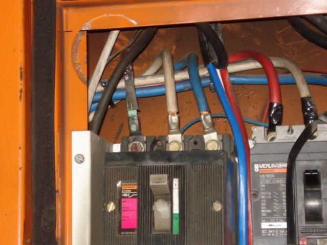

      this was detected during an arc flash assessment in a factory on friday...there are 3 maintenance electrician and a MIE on site my point is not to have a dig at the site electricians...merly to point out the importance of routine visual inspections...i was burnt badly and almost blinded from a wire which burnt like this...the 3 phases shorted out and tripped a 1500 amp breaker in the sub...hopefully we saved this one just in time.
