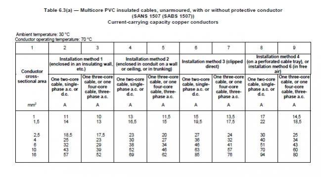

    In particular, wire size. By my reading, the correct wire size for an outlet on a 20A circuit has to be 4mm^2, not 2.5mm^2, because I'm using "installation method 3" (conductors in conduit in air, in ceiling space). That means I already can't use the 27A claimed for 2.5mm^2 wire on its packaging, and more importantly by the electrical goods sales staff, due to the method alone. Then I add some thermal derating, assuming a roof space temperature of 50C (I measured 10C higher than indoors temp, assuming worst-case 40C in Cape Town); I think the factor was about 0.65 or something - I don't have the spec in front of me. And then I find that the 4mm^2 wire is just *barely* adequate for such a 20A circuit.

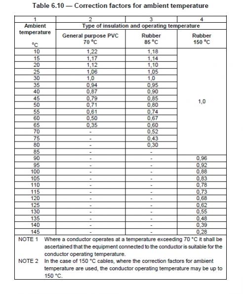

        I just don't see a way to justify running a 20A circuit with 2.5mm^2 wire in South Africa - a pretty warm place, using installation methods that seem to be in common use. Let's take "installation method 2"'s ratings, which to me seems closest to the cable-in-conduit-on-roof-beams that is used in, at least, my house. That's already just 23A, at 30 degrees Celsius - not much margin. Now take thermal derating into account - I think 50 degrees up there in the roof is a reasonable assumption? That's a derating factor of 0.71.
        23A * 0.71 = 16.33A
        So I don't see a 20A circuit breaker adequately protecting a cable with a current-carrying capacity of only 16-odd ampere. Is there some rule that I haven't yet spotted that lets you wriggle out of this?

              From the regs a 2.5mm 2-core cable in conduit in a ceiling has a max current of 23A so long as your ambient temp is 30C or less. Only when you reach 45C or higher ambient temp does the max allowable current fall below 20Amps which is the standard rating of a socket circuit breaker.
              45C is pretty damn warm for a ceiling space. If the temp is higher that 45C then yes, you'd need to go with a 4mm cable. But riddle me this Batman; if you just install a single socket on the end of your cable, would you be covered because it would only be possible to plug in a single appliance which would have a load of 16Amps or less because it has a limitation of 16A plug on it?
                Are you looking at the table for rubber-insulated cables? Because as far as I know we're dealing with PVC-insulated cables. At 45 degrees I see the factor 0.79. 23A * 0.79 gives me 18A.
                And no, Mr Quizmaster, of course the appliance doesn't save you. As Sparks pointed out, the CB is there to protect your cable. To hell with your appliance if it develops a fault! But you're hinting at another odd thing I picked up - the standard specifically allows (can't remember the chapter and verse) for 16A socket outlets on a 20A circuit. But I'm willing to believe that the 16A rating is a switch rating (i.e., can it interrupt that current), rather than a current-carrying capacity.
                As for 45 degrees vs higher... I dunno hey, it doesn't seem that crazy to me to expect at least an occasional 50 degrees. I measured a 10 degree rise over ambient around noon on a sunny day. 40 degrees ambient isn't impossible - even in Cape Town. I suppose with the 150 degree rated cable you can get away with the thinner wire. I might use that for another project that'll come later.
                Thanks for the engaging reply. It's exactly tables 6.2 and 6.10 that I had in mind.

                      No, the tables attached are for PVC but the correction factors table has values for rubber as well.

                              The only thing in doubt here is the maximum ambient temperature of the ceiling space and the corrective value that should be used accordingly. If you come across a ceiling space that's hot enough to warrant sufficient derating of the max current then you should fail the installation on a COC for this reason. The owner of the premises would no doubt install a R50.00 fan unit and invite you back for the retest on a cooler day.
