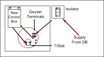

I would appreciate some advice on this. We are an Energy company which does solar water heating installations. The installations usually make ue of a "Geyserwise Max" solar controller to control the electrical heating of the geyser, using time windows. Installation entails interrupting the power supply wiring between the Isolator and the geyser element and connecting this into the controller, which controls when the element can switch on and off. Please advise whether this requires a CoC.
CoC requirements for Solar Water Heating installations
The COC extends to the terminals of the geyser. Whatever is installed between the CB in the DB and those terminals is part of the circuit and must comply with the standards applicable thereto and be certified by way of the COC that it has been installed in compliance with the installation standards too. Should an item be installed to an existing geyser circuit, that circuit has been altered and therefor needs to be inspected tested and re-certified. Untill such time that "installers" are qualified, accredited registered electricians, the companies using employees to install electrical appliances should have electrical contractors subcontracted to them to certify the installation of their products. -

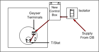

There's more than one way to do this. If the controller interrupts the supply between the isolator and the geyser (dwg1) then certification would be necessary.
If the controller is installed in such a way it becomes an integral part of the geyser itself then maybe no certification is required. (dwg2)_______________________________________________
Quite correct, however, will the geyser manufacturers still honour their guarantee if every Dick, Tom & Harry start fitting "integral" circuitry to their geysers? Or will the consumer find out to his dismay that no-one bothered to find out or inform him that this would be a risk he would have to take, should that be the case? Also, the conductors need to be less than 1m in length to be excluded from the COC. As it is the norm for plumbers to fit geysers in such a way that the electrician cannot access the terminals without without experiencing extreme discomfort, the chances are that the controller would be situated more than 1m from the terminals of the geyser thereby requiring certification.Comment

As sparks pointed out some geysers are not easy to access whereas others may not be a problem at all.
I would personally design the controller to be installed in either configuration as per the schematics I gave above. Maybe supply just a controller and supply separately two installation kits for it, that way you're more likely to cover all bases.As it is the norm for plumbers to fit geysers in such a way that the electrician cannot access the terminals without without experiencing extreme discomfort
On the installations where layout necessitates a layout where COC is required then obviously you'll need to subcontract an IE to issue one. If the installation can be performed as per the second schematic then a COC wouldn't be required and it would be a bonus.
