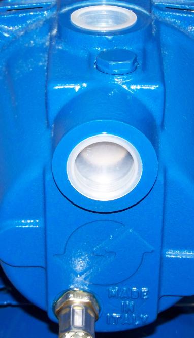

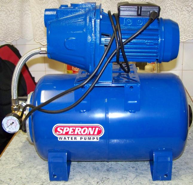

    Well with basically no water ALL the time now I am forced to upgrade to a lager water tank and to that end this damn pump. It has no diagram or flow indication so how do you connect it? I don’t know! I asked the people that work with the stuff and they are more interested to come and do the job for you at a cost of R450 per hour labour but no advice.
    So I included a photo that shows you what I see now I don’t know where the tank is to be connected “source” or the “outlet” any help would be appreciated

    Normally the inflow is the lower point - outflow is the higher.

        As Dave suggested the suction is on the front and the discharge is on the top. Please be carefull, many pumps aren't rated to run dry for extended periods. Damage cause by this won't be covered under warranty.

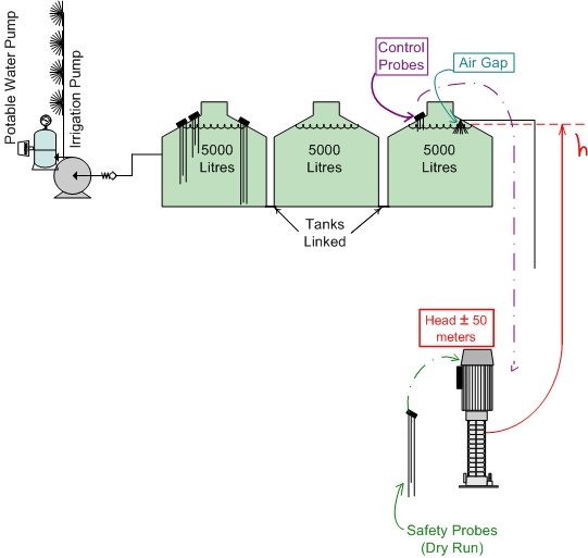

        Here's a drawing of part of a system I specified a few years ago, not sure if it's relevant for your setup or not unless you can give more info..

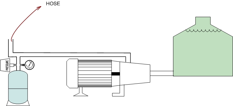

            Schematic would be something like this them.

              This is what I am dealing with and yes I have downloaded the useless manual form the website. Seriously is it that difficult to put 2 stickers on this damn thing. One stating IN and the outer OUT?
              Well this is what you see when you get your pump with the tank pressure thingy... So I am thinking that the best way to test it is by turning it on see if you can identify flow.
              I am thinking however that the top one is the “IN” and the other hole on the side is the “OUT” because of the location of the silver pipe. Well if I am wrong I am wrong...

                    I've never seen a pump connected this way before, I think the braided hose you refer to is connected wrong. The front of the pump is 'in' (suction) and the top of the pump is 'out'(discharge). Connect the hoses and the electrics correctly, undo the small hexagonal brass nut and pour a litre of water into the pump before you switch on. Bob will be your uncle for sure. The schematic above is pretty close to what you're aiming for. The only thing that I didn't show on it is a check valve on the suction side of the pump often referred to as a 'foot valve'.

                        Well I was wrong about the braided hose but the suction is definitely on the front.

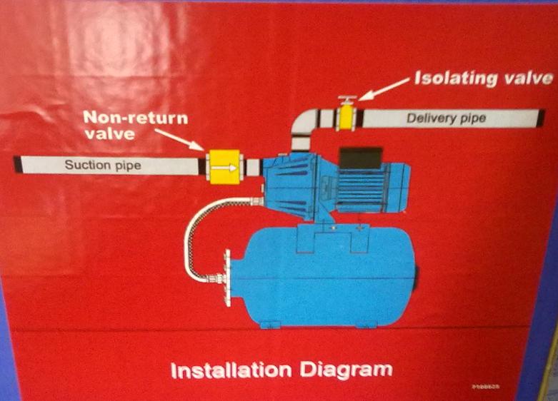

                          I was at the store where I got my pump and they got a new shipment in today. The box is the same and the pump is still the same thing. However it had a nice sticker on the side. Now my box doesn’t have this sticker so I never knew. But here is the truth:
                            That's quite impressive. Usually it's in Chinglish and ambiguous.
