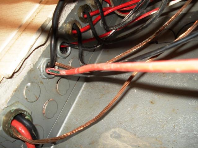

    this is an example of an installation which we found lots of other problems...to start with the COC was illegal because it wasnt even filled in correctly...information missing like the contractors registration number etc...then during a quick visual inspection to verify if the installation required further investigation...this picture below help my decision to do carry out a full investigation.

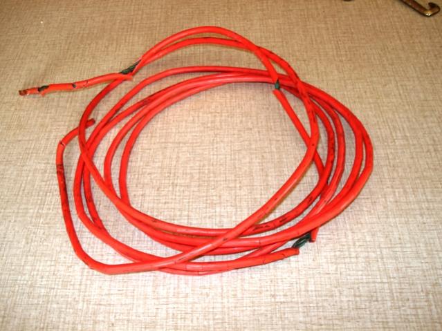

      this COC was issued only a couple of months ago...
      what concerned me was the condition of the stove wire when i replaced it...and the conduit being metal this could have got interesting.
        It's strange the the stove wiring was so badly deteriorated whilst the other wiring looks in good condition.
        Was the circuit overloaded or maybe they used something as a lubricant when installing the wiring which prematurely degraded the PVC.
