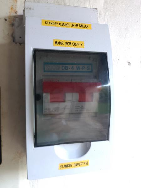

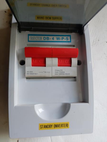

            As an aside, I HATE rotary change over switches. I use those as in photos that fit in a din rail DB and operate similar to an isolator or circuit breaker.
            Most rotary switches are mounted on the lid of the enclosure that houses them.
            We all know how quickly a 10 or 16mm wire becomes a loose connection if moved ever so slightly after fastening.
            Maybe it's only me, but after wiring a rotary switch and then closing the cover on which it is mounted, I always have that little voice asking me if a connection hasn't been disturbed while closing the enclosure and moving the wires. There's no way of knowing without opening the enclosure.
            I suppose we all have our preferences.
