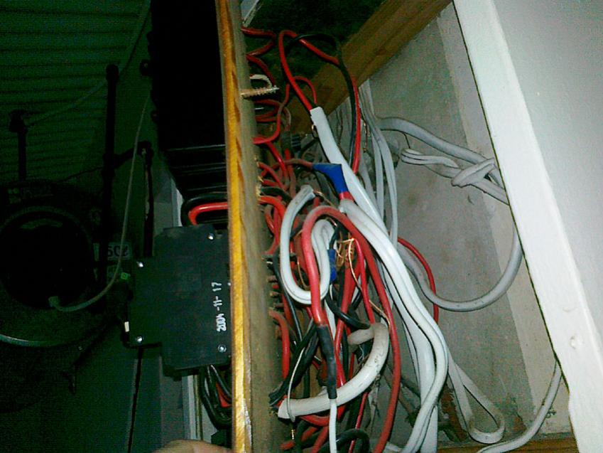

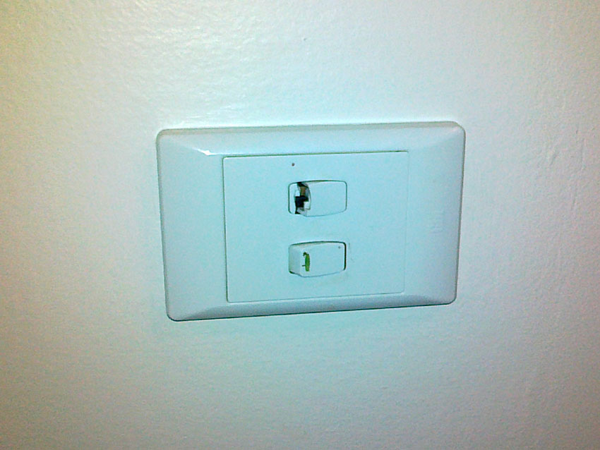

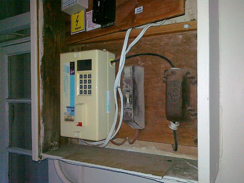

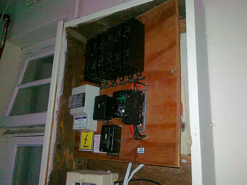

                  Here are some pictures which concern me and please comment on them if you feel they do not comply...

                        Originally posted by MikeS
                        [ATTACH=CONFIG]2008[/ATTACH]
                        Yep,it's non-compliant and shouldn't have been issued a COC. There's several obvious issues such as no labeling, the twisted earth wires, the earth leakage breaker not in an enclosure, the rats nest at the back speaks for itself, the DB looks like it's too high to be easily accessible and it's a bit hazy in the background but the earth bonding on the hot water cylinder looks like it's lacking. There's probably many more issues if this is typical of the rest of the installation.
                        Get a reputable electrician to do another COC inspection from scratch before someone gets injured or worse..

                          eish! dodgy to say the least, although circuit breakers with shrouds are legal.i would fail the complete d.b. and quote on a new surface d.b.
                          no earth leakage neutral bar,no earth bar,what are those twin+earths going to the pre pay meter?
                          there are no changes in the requirements that would make any of those faults acceptable.it has only got more strict.
                            And the way the prepaid meter is wired, it is so simple to by pass, that no one would even notice that there is a bypass in that mangle.
                              Originally posted by bergie
                              ....what are those twin+earths going to the pre pay meter?
                              I wondered the same thing but I cleaned up the photo and it looks like they go into the trunking below the energy dispenser and not actually into it.
