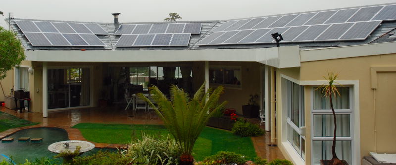

                  see the authorities are not being to encouraging, but check out http://msolarpower.wordpress.com/.
