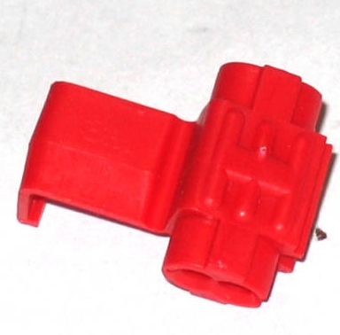

                Originally posted by TECHNICIAN 810
                I use the Hellerman Tyton scotch lock, where you just skin and push in, very conviniant with short ends and hard to reach applications, however not sure if they are compliant.
                If scotch lock's are what I think they are then they're for telephone wires only. They're not rated for 220v nor are they current rated.
                I'm guessing you mean these things...?

                • Sparks
                  • Dec 2009
                  • 909
                  Scotch-locks is the name given for a number of quick couplers. The ones' telkom use are round and can only be used for 2 wires up to 1mm. The scotch locks referred to are a great product from Hellerman Tyton for connecting solid wires like T&E or Surfix up to 2.5mm. They do indeed comply with the requirements for connectors, but must still be enclosed in a junction box. An excellent replacement for screw connectors. They come in 2/3/4/5/6 and 8way blocks which are colour coded. Unfortunately they are scarce in PE, but whenever I can get my hands on some I load up with them. They are multi spring loaded and once used cannot be re-used.
                    I think I'm confused by the trade names. I would call what you're describing 'Wago's' link. Can you link to the item you describe?
