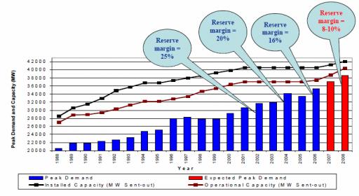

            Just a question on the maths - what is our total capacity supposed to be again? I thought it was more the 39 000 MW.

              From the doc released on Friday it is around 39000MW. Here is the expansion plan.

                  If you look at the figure on pg 10, then the installed capacity is supposed to be around 42GW, but the operational capacity is lower at around 40GW. Possibly they are quoting operational capacity in that table.
                    Duncan
                    Great link thanks. I can't believe how much the electricity usage has gone up in the 90s. Was this a lot chrome alloy plants going up. We have always had the big users like Alusaf Iscor Samancor MSA etc.
